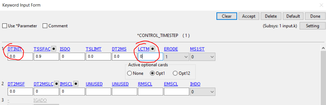

      I am running an explicit dynamic analysis with Ls dyna using a constant time step. I entered my initial time step of 2.75e-5 using the control implicit general card; however, Ls dyna chooses to evaluate the problem with a larger time step. I invoked DTMax as recommended by the ls-dyna user's manual but the software appears to ignore it. Is there another way to make Ls dyna use a particular time step throughout the analysis run time?

      Note that if you run explicit dynamics, the timestep is set by the solver based on the smallest element in your model (element characteristic length), the material stiffness and density (E and rho), and the TSSFAC parameter (default=0.9) on *CONTROL_TIMESTEP. The explicit time step  is governed by the CFL stability criteria:

      For explicit dynamics, you can remove all the *CONTROL_IMPLICIT_ keywords from your model; you don't need them. Also, in explicit dynamics, the timestep is controlled by the solver (see my previous post) and not by the user. Usually, the explicit timestep is small enough (1e-6 or 1e-7 second) and what the user controls is the output frequency of results (*DATABASE_BINARY_D3PLOT, *DATABASE_ASCII, etc.). The timestep will vary a little bit based  on the change in element size with deformation, but the output of results  will remain the same. For example, if the explicit timestep is 1e-6, then you can have constant results output interval at say 1e-4 second.

      In explicit dynamics, you can use *CONTROL_TIMESTEP to specify an initial timestep (this is usually set by the solver) and you can limit the maximum timestep with a load curve (*DEFINE_CURVE) with the LCTM parameter:
      Let me know if this helps or not.
      Reno.
