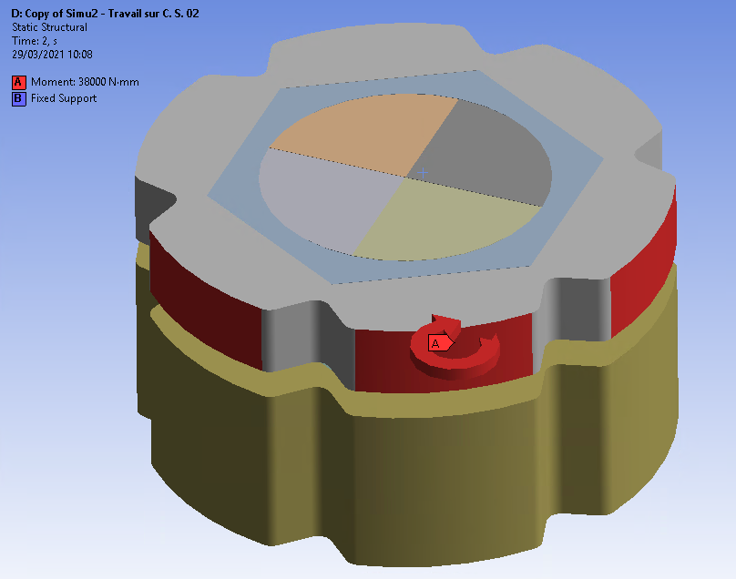

SubscriberIn the case of a simulation on torsional behaviour, my result of the maximum shear stress obtained is different from the theoretical calculation.

Forum ModeratornnI see that you have a corner and it may be a singularity. What if you model a fillet over there and refine the mesh over the result and then check the results. You may see a shoot-up in the stress results.nPlease see if the following link helps:nnnRegards,nAshish KhemkanViewing 1 reply thread- The topic ‘Maximum Shear Stress: Difference between the simulation result and the theoretical calculation’ is closed to new replies.
