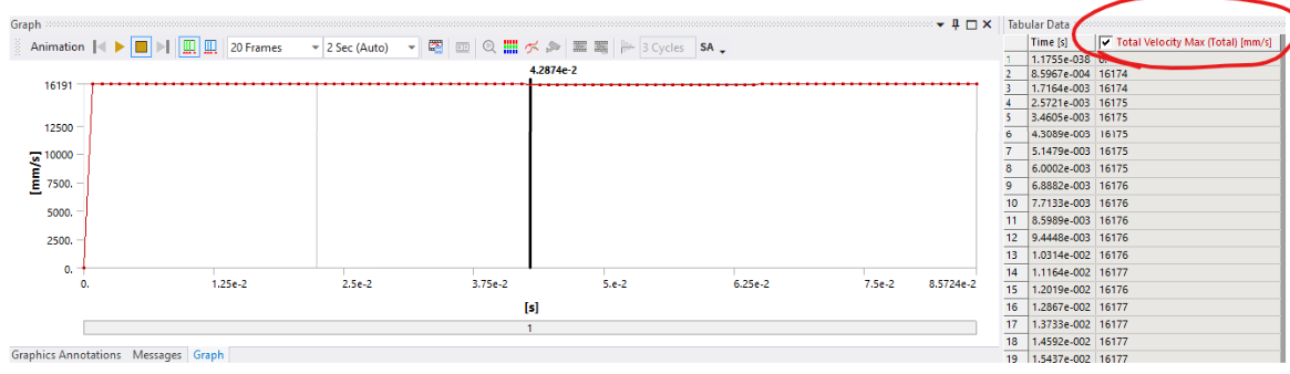

      Hello everyone.
      I am working in Explicit Dynamic in Workbench.

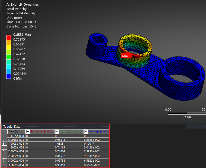

      Does anyone knows what does mean the maximum and the minimum velocyties of the node (or a body) in every time step? why there are no just maximum? what should be analysed: maximum velocity or average?
      I will apriciate your help to understand
      Thank you

      In Ansys Workbench, the maximum, minimum, and average results (such as velocity and stress) are displayed for every time step. These are referred to as the maximum, minimum, or average results for the entire scoped body for the specific time. When analyzing these results, it is important to consider the context and purpose of the analysis. For example, the maximum stress might be more relevant for understanding areas with the highest risk of failure, while the average values provide a better understanding of overall system behavior.

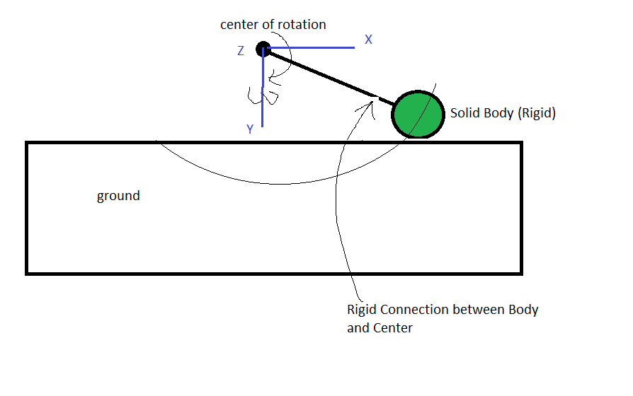

      Model in brief:
      Rigid body rotates around the center of rotation with controled velocity (by motor).
      Body cuts ground.
      Center of rotation is remote point.
      Global coordinate system is located in center of rotation. Body rotates around Z axis.
      Since, explicit dynamic in WB does not have option to apply contsant angular velocilty to body, so I have applied “rotation (deg) vs time” as “remote displacement” boundary condition.
      Body rotates by 180 deg.
      Movement of body starts from the position of touching the ground.
      So, Time “0” – body strats penetrate into ground,
      Time “8.5724e-2″ – body have rotated by 180 deg.
      Also, ansys does not transfer velocity results in cylindrical CS. So, I  linear velocity along X and Y axes extruded, then I convert it into angular velocity.
      If to consider  Total Maximum Velocity, it matches with value of “A = angular velocity multiply by radius of rotation”.
      But, if to consider Total Average Velocity, it much less then A.
      This is confused…

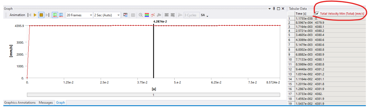

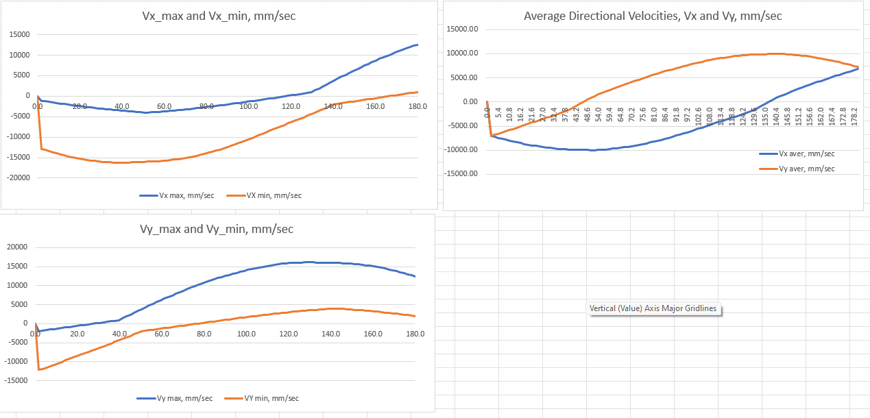

      Graphs of Total and Maximum/Minimum/Average Velocity  for the body are attached.
      Maximum and Minimum velocities are built in excel just for better visualization.Where X axis is degrees of rotation instead of time. So, zero degree means body touching the the ground, 90 deg – body left ground, and  from 90 to 180 deg – body rotates in the air
      Thank you in advanced
      I apprecite your time to consider it

      Note that the radius of rotation in the formula (angular velocity multiplied by the radius of rotation) depends on the location of the node. I believe this is the reason you observe different magnitudes for the minimum, maximum, and average values of total velocity. For example, if the distance from the center of rotation to a circle with a radius of R is X, the maximum and minimum velocities will occur at (X + R) and (X - R), respectively.

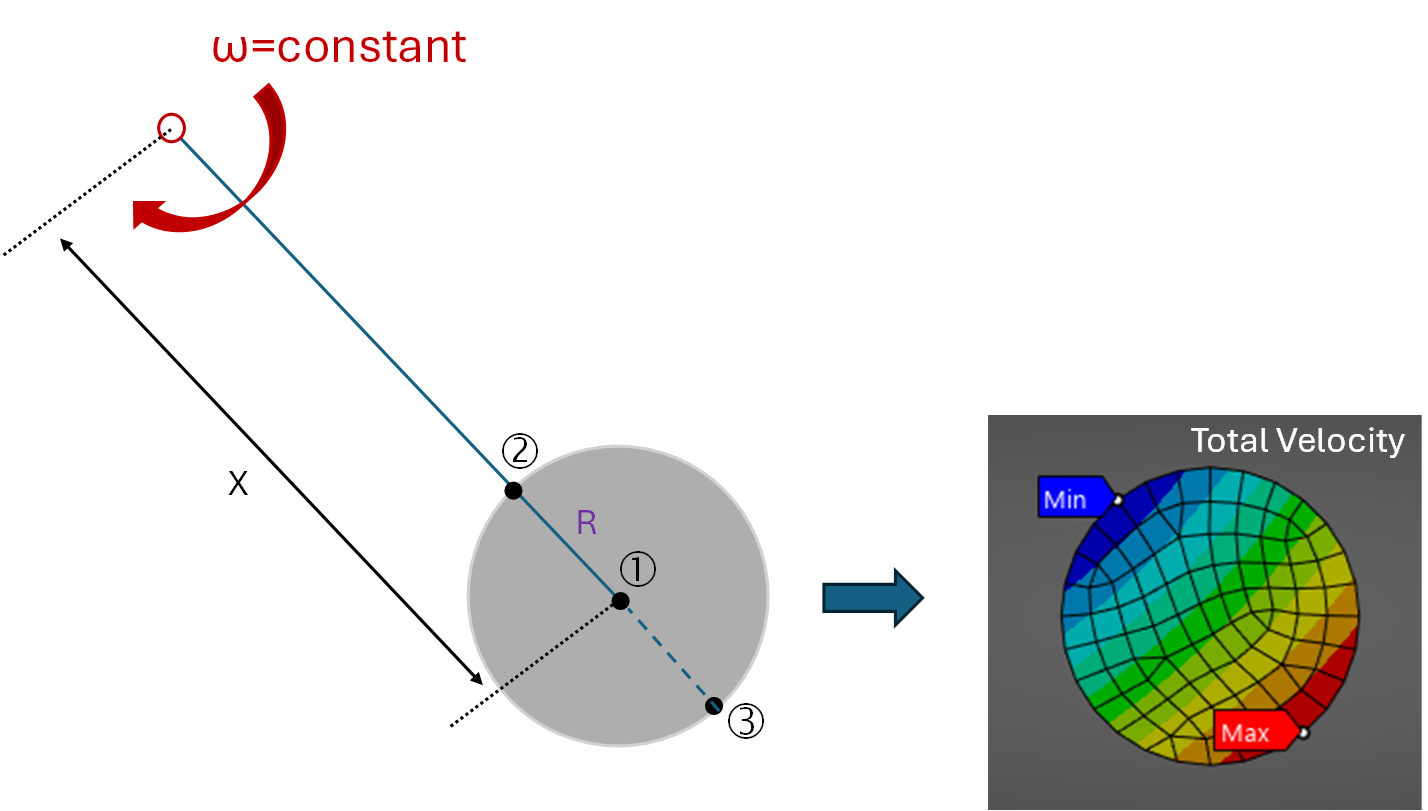

      Hi Marharyta,
      Regarding your question, the angular velocity is constant, but the distance to the center of rotation is not. Please refer to the schematic below: at point 1, the velocity is RW, but it should be (X-R)W at point 2. Similarly, the velocity will be (X+R)W at point 3. This leads to variations in the total velocity contour (despite the constant angular velocity), as shown in the image below.
