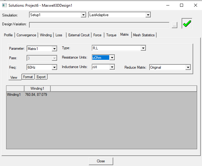

SubscriberHello,
I am working on the Electronics desktop through the virtual labs of my university and I cannot find a specific tab (post processing) to complete a module I am working on (see below for screenshot). Where can I find this feature on the current version? I only have the Setup tab.
August 19, 2021 at 10:39 amNKC

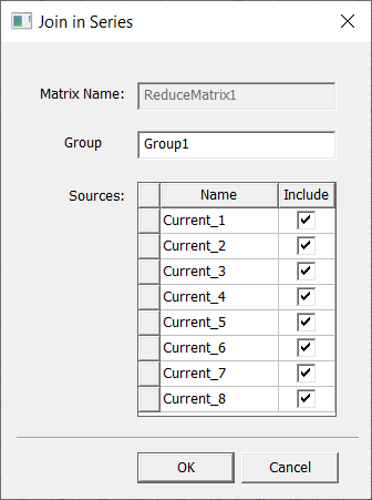

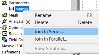

Forum ModeratorHi @cmart283 In the latest version, after defining the matrix, go to project manager window Right-click on Matrix and select join in series(for the case above since all coils are in series) then select all the coils to the group.
then the group will appear under reduced matrix.
Regards Navya
August 19, 2021 at 2:49 pmcmart283
SubscriberGreat, thanks so much!
Cheers Cesar
August 19, 2021 at 4:16 pmcmart283
SubscriberHow would I edit the settings which are located under the Post Processing Tab in the latest version? From the module, I need to change the number of turns and branches to be set to 1.
Or is this accounted for by joining them in series?
August 25, 2021 at 7:10 pmDELI

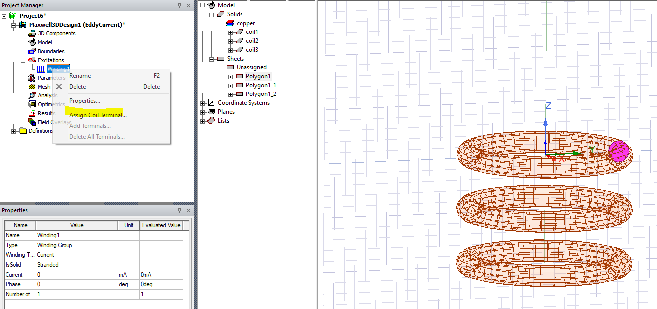

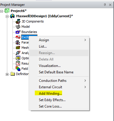

Ansys Employeethis post processing tab has been removed in the latest version. If you would like to set number of turns and connection mode, you can use Winding:
1.right mouse click on excitaiton->Add Winding...
2.Select current type and enter current value, choose stranded or solid winding type:

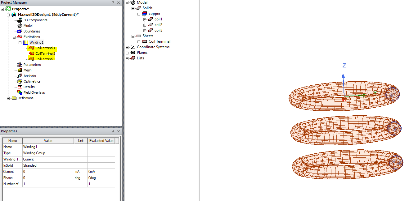

3.select coil cross section->right mouse click on Winding1->Assign Coil Terminal

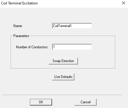

4.Enter Number of conductors
5.repeat the same step to other in series coil terminal.
And you can use matrix parameters to calculate winding inductance and resistance.
Hope this helps :)
