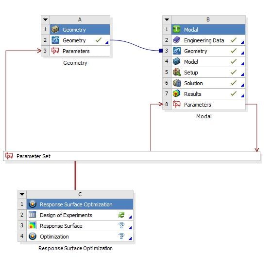

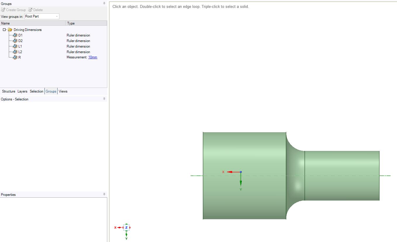

      My problem is very trivial: I want to have an FEM calculation carried out in Ansys for different geometries of a certain structure. Put simply, the geometry consists of two cylinders with different diameters placed on top of each other, with one cylinder merging into the other over a radius. I hope the geometry is understandable, otherwise I'll send you a drawing.
      It is now possible for me to parameterize the two diameters in Spaceclaim and to run a simulation over the parameter space. What I currently still fail with is the transition radius: In the previous simulation this was assumed to be fixed, but in reality it is the difference between the two diameters. Can this simple equation (R = D2 - D1) be defined as a function somewhere?

      In Workbench, within Parameters, you can use Expressions. That means that you can put P2 as a function of P1. In SpaceClaim you can also use the Ruler tool to set parameters as distances from given references.
    • lux88
      Doing this, I receive this error:
       (DP 0) Update of the Solution component in Modal for Design Point 0 failed: Error updating cell Solution in system Modal.
      Although it works perfectly fine by typing in values manually in Spaceclaim.

    • lux88
      Here some images:
      1. My Geometry with 5 Parameters. R is defined in workbench as "D2 - D1"
      2.
      3.
      The solution for only 2 design points. Point 0 works good with the initial geometry of the CAD-File. DP 1 results in this error.
