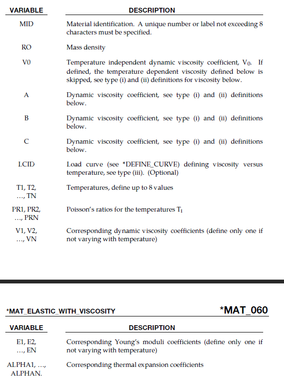

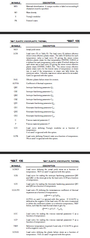

      Based on your information, I came into conclusion as followsnFirst Thing, MAT102/MAT_INV_HYPERBOLIC_SIN_{OPTIONAL} is not supported by SPH element. Please check the followign link for supported SPH formulations.nBased on the Material properties that are defined in above comment, like nTemperature Vs Viscosity ----> Looks more like a Fluid Formulation. nStress Vs Strain as function of Temperature nThis is supported in MAT_106[MT_ELASTIC_VISCOPLASTIC_THERMAL] but the Temperature VS Viscosity is to be modelled as Harding (Isotropic and Kinematic) Coefficients, That said, the flowablity of the material ,mainly plastics, is defined by how soft they are for their respective temperatures so why not model them as function of VISCOELASTIC terms.nAlternative solution,nIf you remove the constriaints of SPH, you can unlock more straight forward material cards which will directly support your data natively, for the hot plastics use the following Material Cardsn*MAT_60 (*MAT_ELASTIC_WITH_VISCOSITY)-------********The Best Solution********nn*MAT_106 (*MAT_ELASTIC_VISCOPLASTIC_THERMAL)nComment down your response for futher support.nAll the best, Cheers,nRamn

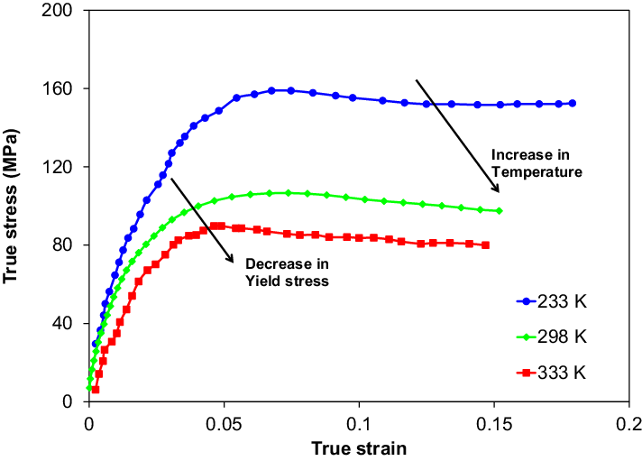

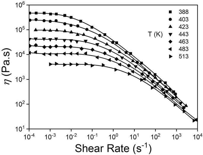

      thank you. my polymer properties is something like picture below. also i build Eos linear polynomial model for simulation. ncan i combine this data in one mat ? (my simulation start in room temperature an it goes up over 500 k). my problem is about material flow. and im solved in fluent. but i want use sph method for better result in simulation. nbest regards.n
    • ramgopisetti
      Can you elaborate your study like what are you trying to find out and implement. SPH also support MAT_NULL which has Density , Dynamic Viscosity at room temperature , Pressure cut-off and this model needs EOS, more like an fluid type . This is one such approach to workaround the your problem. Can u able to show an instance of the results for better assistance. nCheers, nRamn
