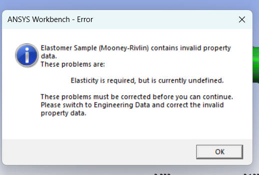

I am using silicon rubber as a main material in my simulation but when I define this material by entering its properties ( Young's modulus, Poisson's ratio and density), I get wrong results. But when I use Silicon rubber from the Engineering data of the Ansys,workbench everything goes well. There problem is that there is no data shown in its data library to see what is the Young's modulus or other data of that.
Can anyone help me out to find the material properties of the Silicon rubber in the Ansys?

SubscriberHi Amin,
Please spell silicone rubber with an "e" on the end.
The silicone rubber in the Engineering Data is under the Granta samples.
There is no Young's Modulus because it is a nonlinear material.
It uses a Mooney-Rivlen 2 parameter hyperelastic material model.
You can estimate the Young's modulus for low values of strain from the initial slope of the Stress-Strain curve. E = 1.8 MPa.

So it's a very flexible material. But I can't understand the reason of differences in  the results of the Silicone rubber using Ansys engineering data and what I defined with E=1.9 GPa and Density= 1250 kg/m*3 and Poisson ratio= 0.495.
For the higher Young's modulus (1.9GPa), reults are not symmetric while in the flexible one (1.8Mpa) are fully symmetric:
