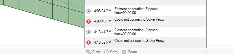

      When I am running Material designer in Ansys workbench, everything is going fine but when I am solving to get results in Material Designer it is showing "Could not connect to SolverProxy".
      I am also enclosing screenshot please check.

      I've seen this problem once before. In that case, the problem was to down to a space in the Windows username. This caused problems when calling files from AppData (C:UsersAppDataLocalTemp). The problem has been corrected in 2019 R2. So either upgrade or check your windows username once....

    • Sandeep Medikonda
      Ok, what is your windows user name?

    • Sandeep Medikonda
      I think that is where the problem is, try to avoid special characters such as '-' or '' in the username.

      I heard back from one of our developers on this and this is what they had to say:
      One of the methods for retrieving the username gives you “DOMAINusername”. I am not sure whether the entry provided means “desktop-gd8d0j3ismela user” or “desktop-gd8d0j3ismela”. Both cases should be covered in 2019 R2 so I’d be surprised if this is the issue.
       The student should check where the temp directory leads to. To access the temp directory enter ”%temp%” into the address line of the Windows Explorer. Then you can copy the absolute path back out again.
       A second thing to check is whether the process DSSolverProxy2.exe is started.
       Also read-write access to the temp directory could be an issue. Although this is unlikely.

    • viv123
      Dear SandeepMedikonda Ji,
      I tried again from my Pc with unidirectional RVE but the message is coming could not connect to slover proxy, i am sending the error message to you. Everything is working till setting but at the time of analysis run for results this message is coming.

    • Sandeep Medikonda
      Which school are you from? Please reach out to the account manager or Ansys Support Coordinator (ASC) at your school and request them to escalate this to ANSYS technical support.
