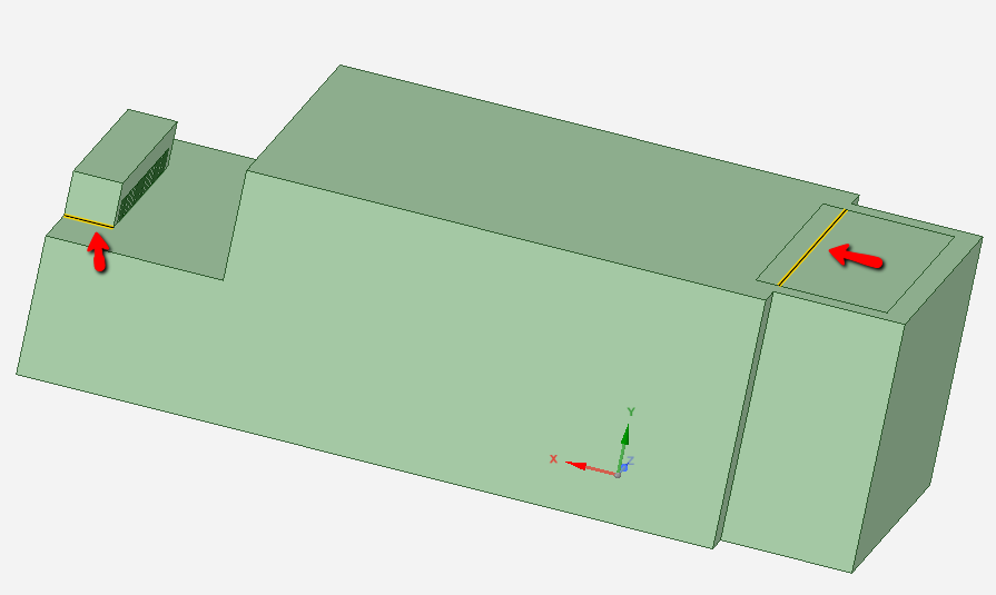

    • ghassan.abusultanah
      Subashni This simple 100'x100' hanger, with supply Air from the front and Exahust from the top as shown in attached picture

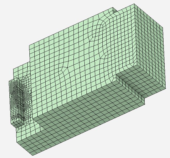

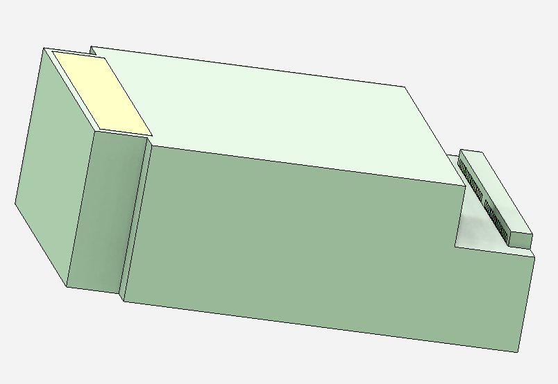

    • subashni.satish
      Hello Ghassan. AbuSultanah
      I created a geometry quite similar to your image and made a few splits as shown in the attached image and mesh task was successful.
       You may apply similar splits to your geometry and give it a try.

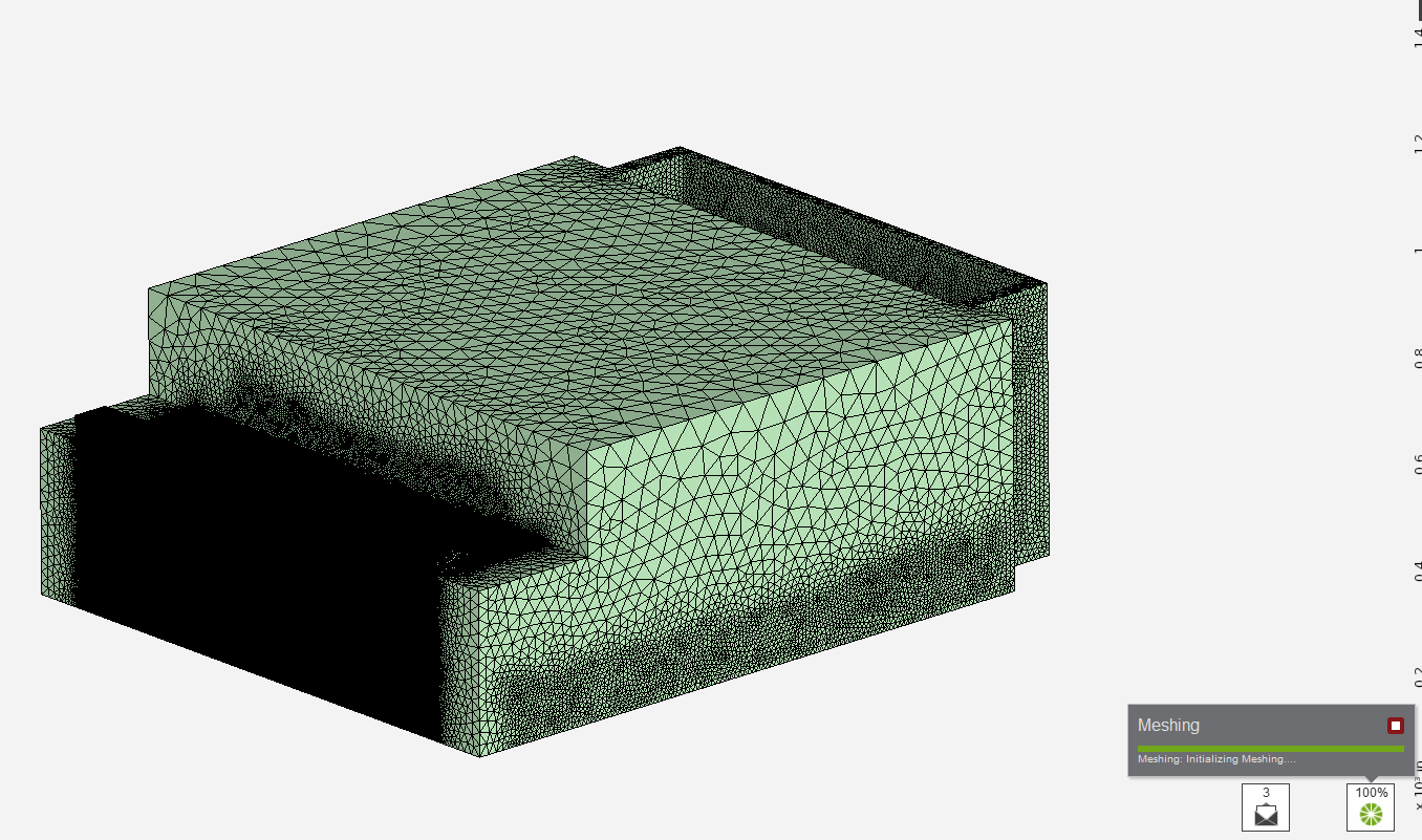

      Subashni
      The mesh for solid is created successfully but not for the Air Volume Inside. Could you please share with me the mesh settings you are using ? Please see the picture below for the mesh I got for the solid part.
