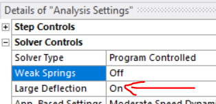

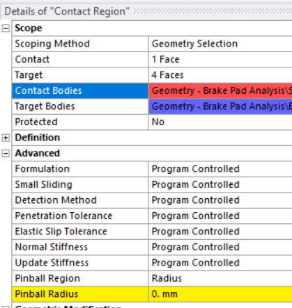

      Based on the maximum possible gap between the two bodies define a slightly larger pinball radius than the gap and see if that helps. Also, please see if you have the Large Deflections turned on.

      Thanks for your suggestion, I've tried it but unfortunately it's still not working, the warnings ask for user input

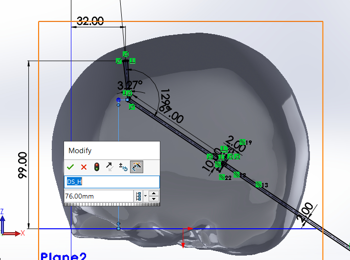

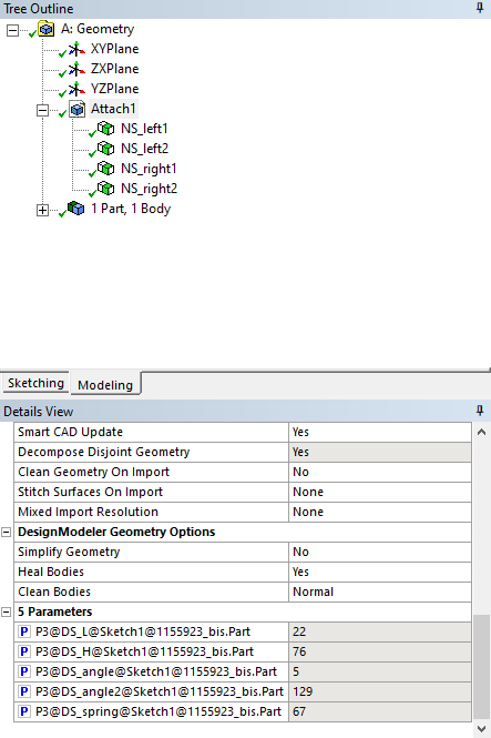

      I used the existing link between Solidworks and Ansys: the parameters and the cuts are made in Solidworks (defined as "DS_example") and then the shells are imported as "geometry" and the parameters that I want to use later are selected in DM
      If you are using the Solidwork-Ansys Geometry Interface correctly, there is no need to use DM. The parameters should be defined in Solidworks and show up in Mechanical as CAD parameters with a DS_ prefix. Please insert some image in your reply to show exactly what you did in Solidwork and Mechanical.
    • LaraDlg
      Here is the solidworks picture with the parameter definition and then the selection in DM. I've performed some DoE for this study before and it worked well but it's the first time I try to include manually defined contact. The outer shell is imported as a geometry from solidworks as well but without any parameter and it seems like this shell is the problem because it disappears (the BC for this second shell are lost). Maybe I should try to import them together from solidworks but they both have different material properties and thicknesses.
