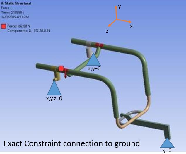

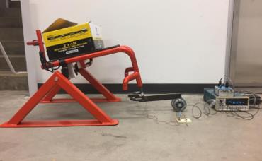

The part I’m looking at is actually part of a larger wheelchair frame model. Originally, I didn’t model any wheels and had frictionless boundary conditions at the wheel locations. However, I was finding that the model was overconstrained because it didn’t allow for any rotation, and it wasn’t matching my physical validation model, which I’m doing using with strain gauges. So I am hoping that by inputting wheels into the model, I can allow for both rotation and forward translation when a downwards load is applied to the chair.

If you are interested in the stress on a wheelchair frame, you might not need wheels or a ground surface to do that. You could create a Remote Displacement scoped to the part of the frame where the wheel connects to the frame and make the remote point at the center of the axle. Since there are two wheels on the ground sharing a common axle, are you assuming the axle has some clearance so the arm can rock between the two wheels freely for a few degrees? If so, that is the point to put the remote point. The Remote Displacement can provide just one constraint, y=0 so everything else is free on two of the "wheels". If you have four wheels, you will have to make one remote displacement have x,y,z = 0 to anchor the frame to a point, while another remote displacement separated along the x axis from the first "wheel" will have y,z=0 to stop the wheelchair frame from spinning about the x,y,z=0 point.
Alternatively, if there is a very stiff and clearance-free connection of the axle to the arm, say through a pair of roller bearings, then you probably need two wheels on the ground surface so the pressure of each wheel to the ground can be different as the frame distorts under load.
Let me know which case applies and reply with an image of the wheelchair frame and the loads you want to apply to it.

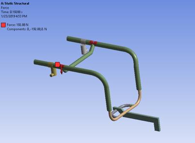

SubscriberThanks for your response. I think I'm looking at the second case. At the moment, I'm looking at a 1000N static downward load applied to the top of the wheelchair. I've attached a picture below of both my physical and my FEA model. However, I'm also planning to look at failures associated with fatigue, and will need to model the chair moving so that would be a different load case.Â

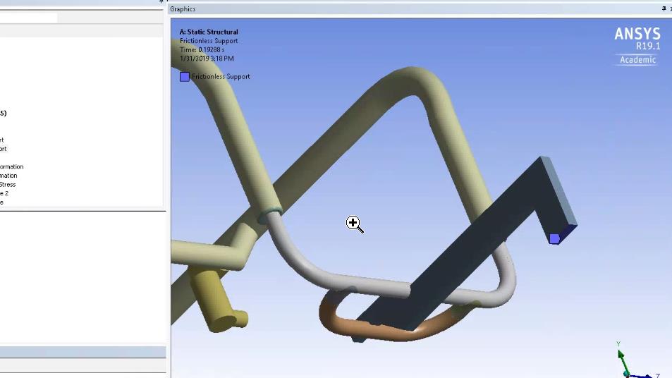

SubscriberHi Colleen,
I deliberately have different constraints on one big wheel axle vs. the other wheel axle.
In your model, the X axis is along the cylindrical axis of the two axles. If you have two cylindrical supports along the same axis, then you need a constraint to prevent motion along that axis. That is why one of the two has x,y,z=0 constraint to stop motion along that axis.
I am suggesting a Remote Displacement on those cylindrical faces that leaves rotations free. This is more realistically representing how the axles are free to rotate given they have a big wheel mounted to the axle.
I am also suggesting a Remote Displacement on the face where you show a Frictionless Support on the end of the trailing arm. The Fritionless Support is holding that face flat and not allowing Y displacement but also not allowing rotation about X or Z. By replacing the Frictionless Support with a Remote Displacement that only has Y=0 and leaves all other DOF free, the frame will be free to distort in a realistic way.
