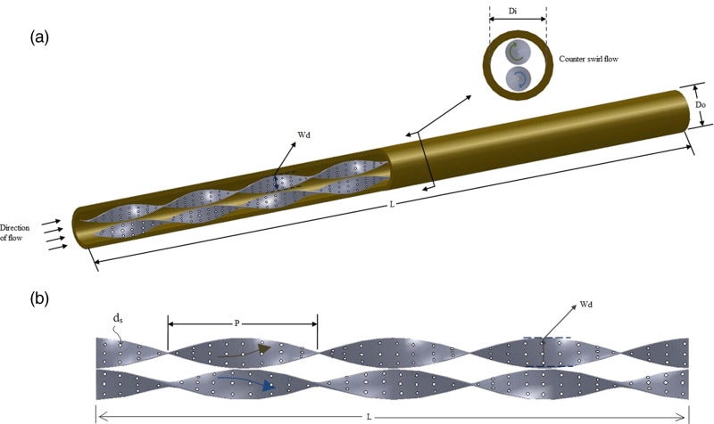

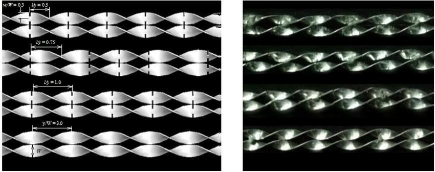

      I am going to use Ansys Fluent to do the CFD analysis on 2 different geometries to investigate heat transfer enhancement features like Nusselt number, Friction factor, and Eta: both geometries are a tube with double perforated twisted tape inserts. The difference is the type of hole(one is circle and the other is rectangle). Based on the videos I have found, I know how to make a twisted tape insert in a tube. My questions are:
      how to make the holes on the created double twisted tape inserts based on the following images?(Is it possible to make multiple holes on a rectangular plate  using "pattern" feature in design modeler then twist it? If yes, how?)

      Making the twisted ribbon is relatively simple, use the Sweep method. Adding the holes isn't as I can't see a way of getting pattern to translate and rotate, you'd want to use cylinders and then subtract too: getting the "holes" to align with the ribbon will be virtually impossible given surface definitions and tolerances.

      Holes I can't help with, other than to work out the axis of each and then create.
