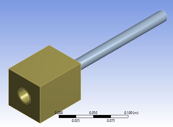

      I am having a difficulty to create a uniform inflation on a wall that has a narrow face near the corner.
      Problem description:
      An (isolated) geometry consists of two regions: a thin wall cylinder ("gap") that is connected to a larger "volume" on one of its faces
       Geometry Geometry Crossection
      The model will be a heat transfer with natural convection in Fluent. Both regions will be the same material (air).
      The convection will be modeled in the "volume" only.
      The "gap" will have heat conduction only, however will need to resolve a sharp gradient (between a heater and a body being heated), so few elements are needed across it.
      I mesh the gap first with hexahedral elements (multizone or sweep).
      Then the  "volume" with automatic or tetrahedral algorithm, with prescribed inflation (Total thickness) on the walls and also the same inflation on the imaginary surface between the gap and the volume:

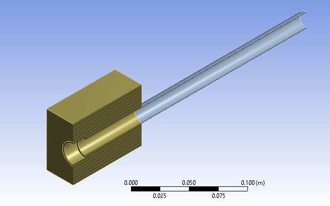

       Mesh cross-section Mesh cross-section, view from the right side
    • vladr
      The problem is that in the corner where the gap is connected to the "volume", the inflation layer gets compressed:
      Problematic region
      I guess that this is because the inflation forces elements to have their thickness (normal to the "wall") to be not greater than its length (parallel to the "wall"). However, I could not find if there is any parameter that can "relax" that requirement.

      I have found the solution to some extent: the permissible ratio of the height of the element in the inflation layer over is width is controlled with a "Maximum height over base" parameter in the global mesh inflation group under the advanced settings.
      The maximum is 5 and it didn't solve it completely. Increasing the Total Thickness of the inflation on the problematic face also did not help to completely equalize the thickness of the layers near the corner. Only decreasing the thickness elsewhere helped to achieve what I wanted (here I also used twice less elements across the gap than in the initial post):
      Corrected inflation layer thickness in the corner. Skeweness colormap.
      However now I have a problem which I left out in my initial question: the tetrahedral mesh in that corner has few elements of a very poor quality (the colormap in the pic is a Skeweness). I have no clear vision how to improve it and just tweak global sizing parameters as well as playing with element size on the adjacent faces. Can anyone suggest any ideas which way to go, which parameters to focus on to improve these few tetrahedrons in the corner?
