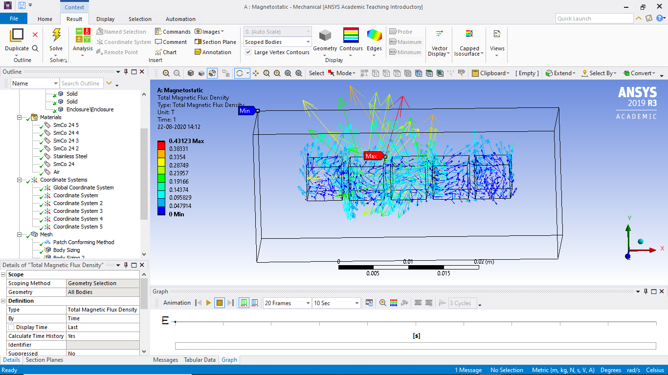

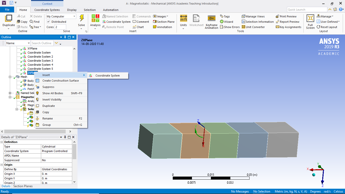

I am trying to simulate the Halbach array in flat magnet array configuration with samarium cobalt magnets. I have defined the polarization direction for each magnet by creating a coordinate system and duplicating the material property. I have successfully performed the simulation but I am not able to visualize the field distribution as shown in the figure. I tried different graphic settings using vector display but failed to achieve the desired field distribution. Should I change the analysis settings? or there should there be some changes in the graphic settings? Or do i have to generate a 2-D geometry for the 3-D model? Can anyone guide me here?

SubscriberHello,nI believe you need to go back to CAD and add a large solid block around the magnets and assign that block the material property of air. nThe solid block must have a magnet shaped cavity at the center. SpaceClaim can do this for you by using the Enclosure tool.nYou also want to use the Share button on the Workbench tab to create shared topology so the mesh connects from the magnet to the air.nAugust 22, 2020 at 12:21 pmPD1029
SubscribernI followed your advice. I created an enclosure and also used the share topology tool. Still I am not getting the desired result.nI want to get the result as shown in the figure belownnIn order to achieve the magnetic polarization, I created a duplicate material property and a co-ordinate system for each magnet and assigned the direction as demonstrated in the image above.nI am attaching the simulation results. Kindly take a look. My aim is to be able to show the field lines as shown in the Halbach array image. Do I have to change some analysis settings or it can be achieved by changing the visualization in the simulation?n

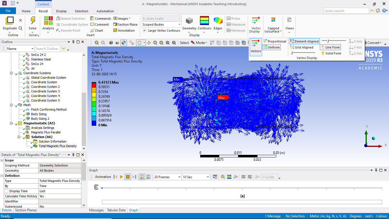

nnIn the graphics, there are two options - uniform and proportional vectors. I have chosen proportional to in order to visualize the field distribution. Since, the vectors with blue color shows 0T it is of no use. However, I have provided an image below showing with the uniform vector selection. Kindly guide me here, what has to be done.n

SubscriberYou will have better control if you plot contours rather than vectors.nI agree with that you want to plot those on a Construction Plane, but put that plane through the center of the magnets, not on the surface.nIt will be best to plot the air body only and not all bodies and you can use the Scope line in a result plot to do that.nThe legend on a contour plot is very adjustable. You can start off by choosing between linear and logarithmic spacing. You can increase the number of contour bands, you can change the plot from solid fill to lines, and you can adjust individual iso levels all on the legend.nIf you clear out the mesh, and save the model, you can do a File, Archive to create a .wbpz file. You can use the paperclip icon in your reply to attach that file. Then I can try out on your model what I have suggested above.nAugust 23, 2020 at 4:28 pmPD1029

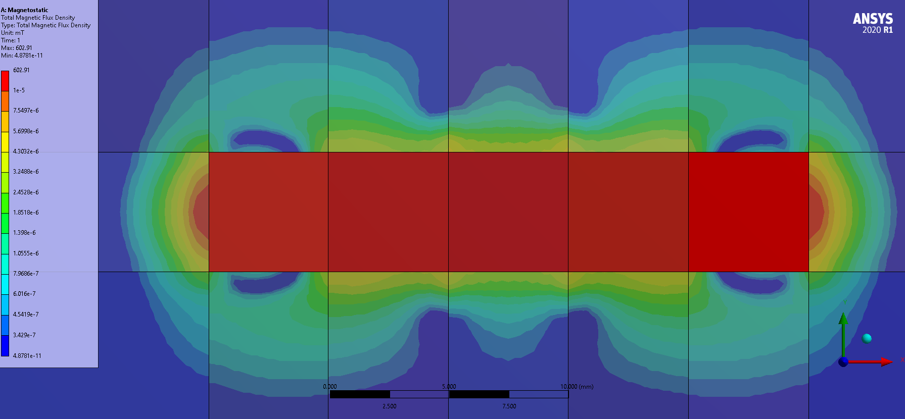

SubscriberI was able to do some work on this model, but only in 2020 R1, so unfortunately, you can't open the model I worked on.nI changed all the Extrudes from Add Material to Add Frozen. That let me edit all the sketches so there was no air gap between the magnets. Those small gaps just made meshing the air to be inefficient. Once the blocks all touched, the air could be meshed more efficiently. I used 10 planes to slice the air up into blocks so that it could be meshed with 0.5 mm cubes. The mesh has 2.2M nodes and 539,000 elements.nNow when I change the direction of the coordinate systems to match the original diagram, I get this:n
Note: I don't know how to use Magneto-Statics, but this seems to be closer to what you want.n

SubscriberYes, my mesh had 2.2 million nodes, so I got nice smooth contours. Your contours will be more choppy.nOctober 12, 2020 at 8:45 amPD1029
