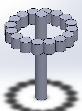

      I am trying to simulate a circular array of permanent magnet (cylindrical shaped). I wish to assign a different direction of magnetization to each of the permanent magnet cylinders, similar to the images below. How do I go about doing that?
      This is the CAD model.

      Please reference Maxwell online help:
      Getting Started with Maxwell: A 2D Magnetostatic Solenoid Problem
      In particular, follow steps below to assign unique magnetization directions:
      Assign Neo35 to the Core and Specify Direction of Magnetization
      Create a Relative Coordinate System for the Magnet Orientation
      Complete the Alignment of the Magnet
