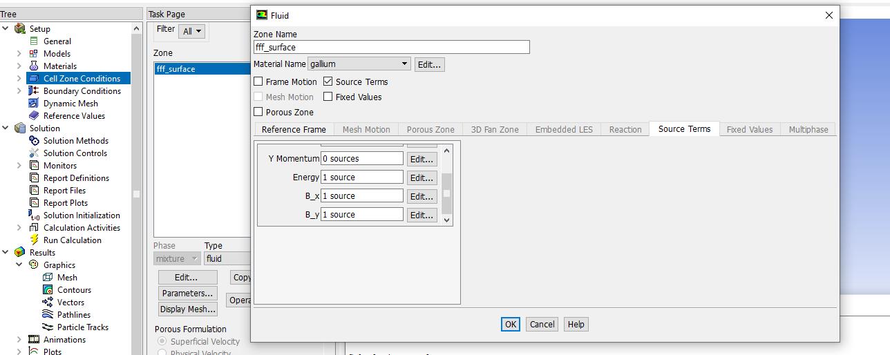

      I'm trying to apply a constant magnetic field on a closed-loop cycle, and I have good results without magnetic field. Applying magnetic field must affect on the mass flow rate, therefore the velocity must decrease.
      The problem is:
      There is no effect on the velocity when I apply the magnetic field at the right and left walls of the loop (x-direction).
      I think I have a problem with applying magnetic field in fluent, is there any tutorial that helps me to understand the concept of MHD? , or may you help me here, if you worked on that before?
      Note: I've used the manual when I applied MHD, so I need your experience with MHD.
      Thanks a lot

      yes, you're right. The contours of the field have been appeared but that didn't affect the fluid. I don't know why the fluid did not pick the magnetic field so far, so I need your help about how can I say to fluent: "The magnetic field must affect the fluid flow".
      plz see an attached pic if I have to change anything with,
