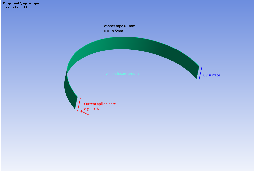

      I would like to simulate a magnetic field behavior around a copper tape, including the inside the tape itself:
      Radius of the tape is 18.5mm
      thickness 0.1mm
      height 4mm
      One face of the tape is connected to GND on the other I apply a current of 100 A. Here you can found the setup for better understanding. The air enclosure is not included here:

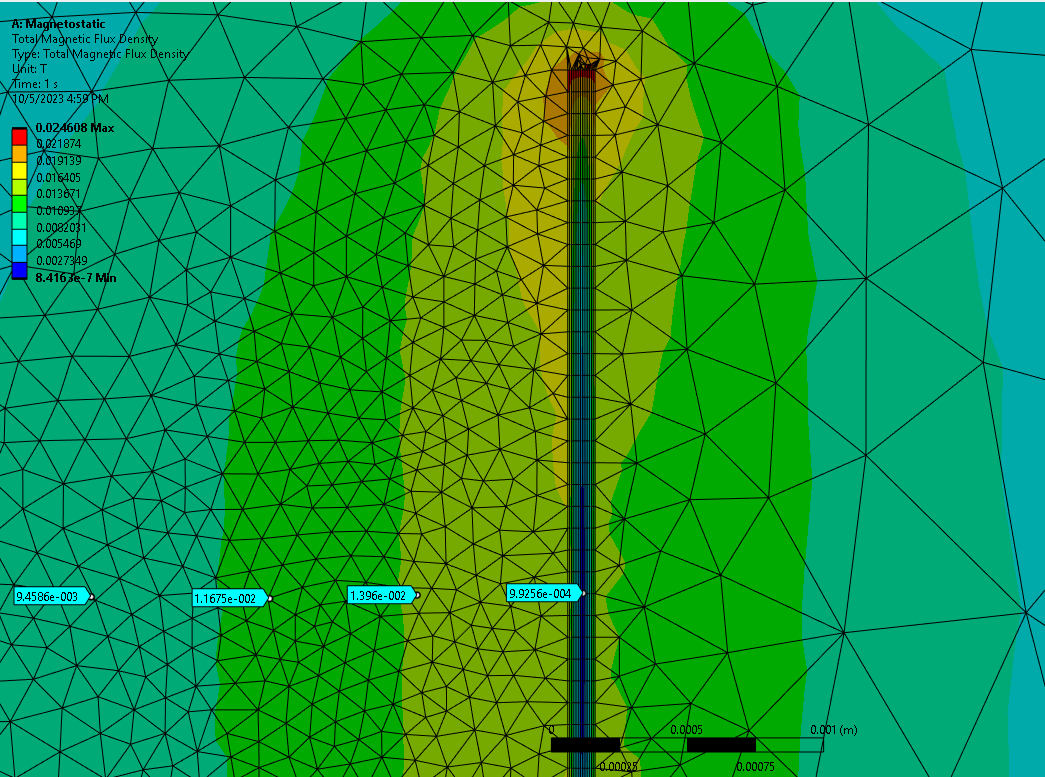

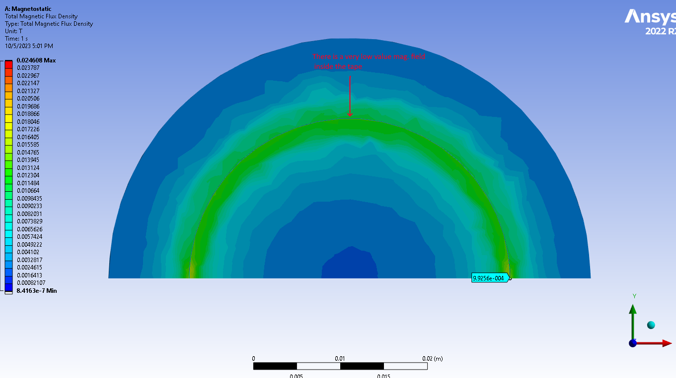

      Problem appears, when I solve the problem the magnetic field inside the tape is always very small:
      1. question: What I am doing wrong? Should I increase the number of mesh divisions inside the tape?

      Actually, physically, we expect the B field inside the conductor domain to become lower as we go progressively further from the “air”-conductor interface. Consider:
      This is consistent with what I’ve seen doing magnetic field calculations. As an academic exercise, you might try modeling a straight conductor (after the system posed in the link above) and see if the field drops off linearly with R. My hunch is that your mesh is almost certainly adequate – no need for further refinement.

      Thank you for clearing me out the situation, actually after a while with little help, I also found that. So this is a normal behavior and shows a nice details of the magnetic field rather than an issue with the model. Thanks.
