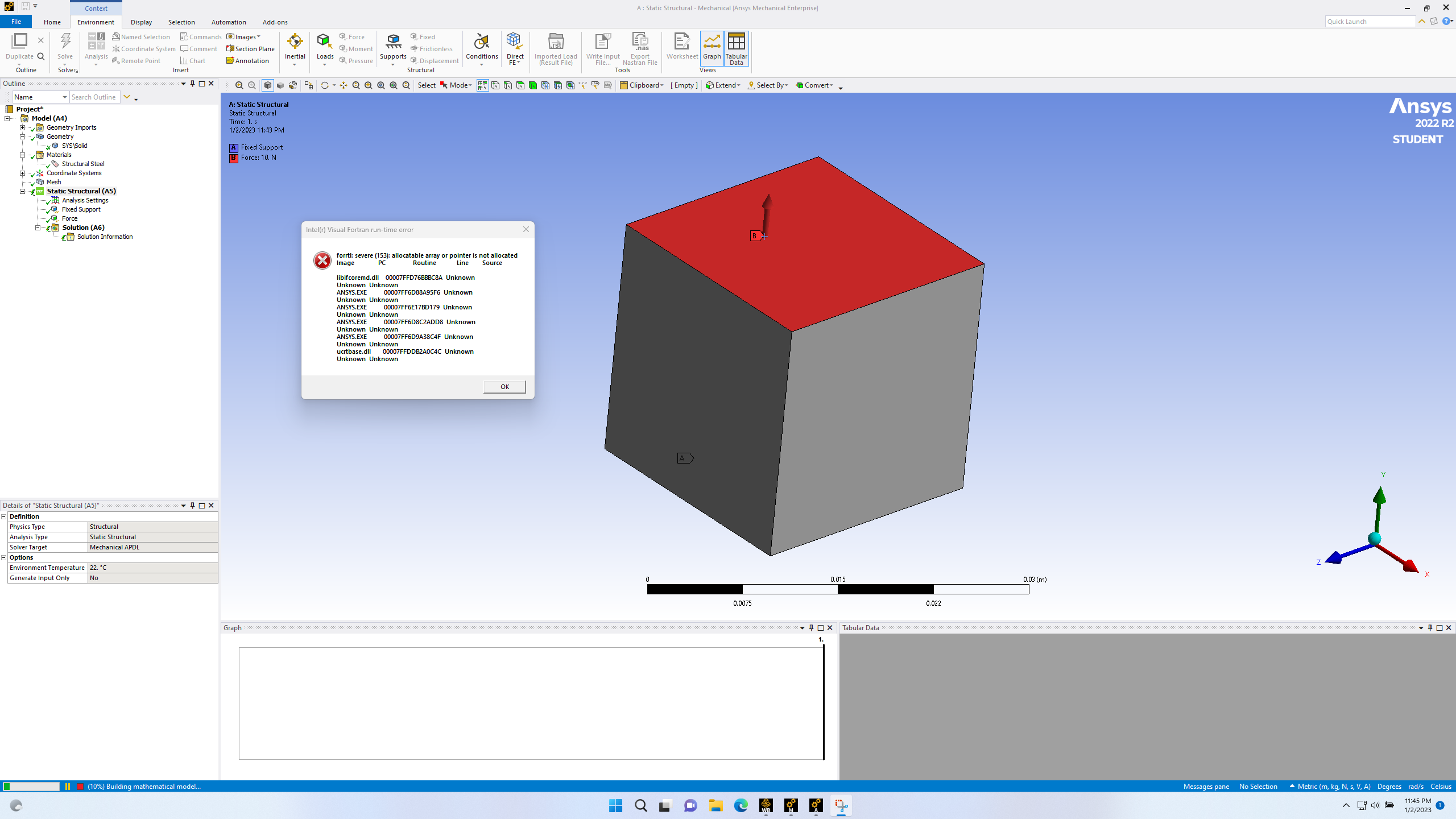

      I'm running into some problems installing and running ansys. Windows 10 is the only platform that the student package is supported on, but there are no more supported windows 10 for ARM images. Only windows 11 for ARM. I'm running windows 11 on parallels and completed the installation using the instructions from this video.
      . Unfortunately, when I try to run a very simple test program in ansys mechanical, I get the following issue. Is this something that people recognize? Could this be caused by running in windows 11?
      Fortran Runtime Error
      We've been testing Win11 internally with minimal issues other than a few hiccups finding DOS prompts and the like. It's possible there's something missing in the Mac interaction stuff as I suspect they didn't expect you to need compilers. 2023R1 is due "soon", so that might fix the issue as that's (I think) supported on Win11.

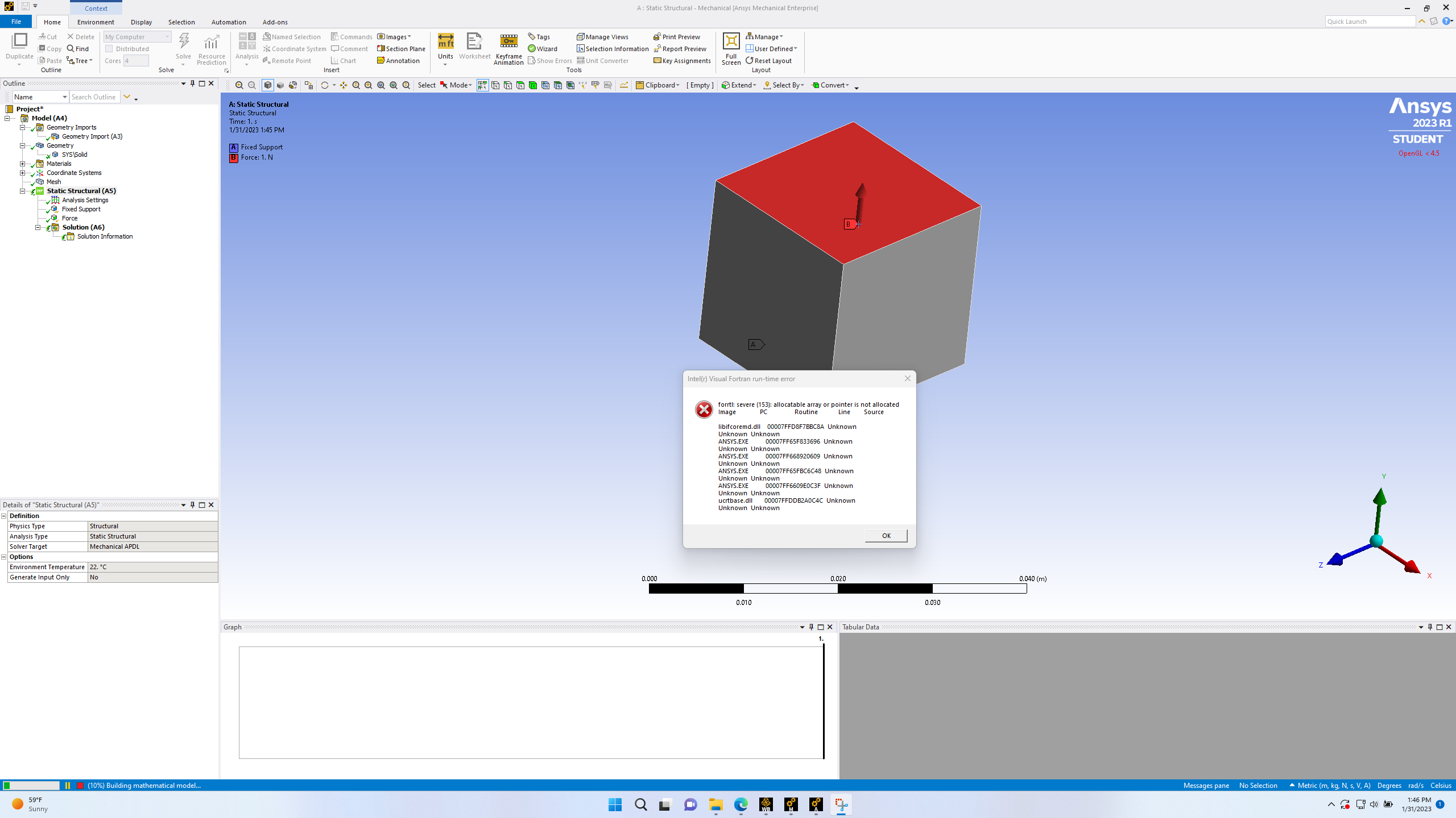

    • Austin Glover
      Hi Rob,
      I downloaded 2023 R1 recently, and it has the same error. Fortran Error
      At a high level, is ANSYS just not supported for ARM based macbooks? What is your recomendation for someone who has a ARM laptop who want to use ansys?

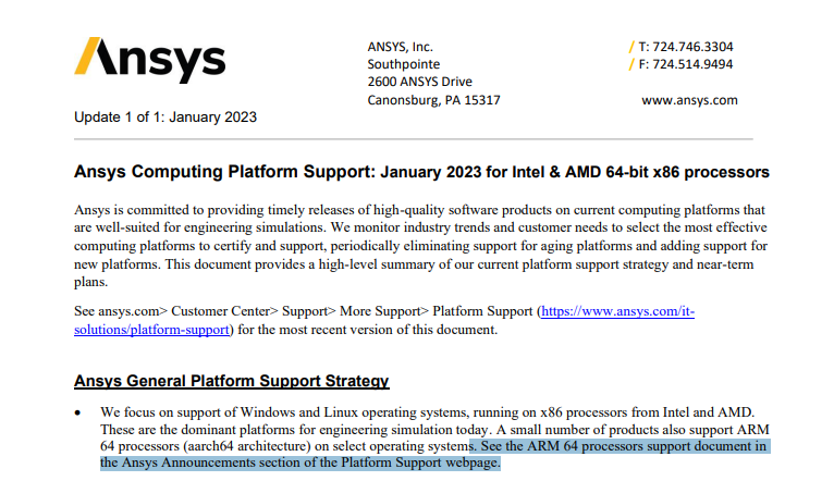

      The support document says to:
      But there's no document where they are pointing.
      I'll check. That document may not yet be on the system as we're still adding 2023R1 to the system. Note, the document mentions it's a small number of products so you may find it's not the one you're after.
    • Marie Elieza Bagus
      Has anyone found a solution to this? I am having an issue on the OpenGL 4.5 requirement. Same with OP, I am using Parallels on Win11 ARM.
      Here's the ARM document, https://www.ansys.com/content/dam/it-solutions/platform-support/arm-64-processor-support-announcement-january-2023.pdf
      So does this mean I cannot run other Ansys products aside from Fluent and Redhawk?
    • George Karnos
      That is correct.
      Ansys Products, other than mentioned are not supported on the ARM CPU.
      Also, the ones mentioned are only supported on the Operating Systems listed. (Linux)

      I used the same video to install ansys on my M2 mac. Fluent is working fine so far. I get the same error message though when I try to launch APDL and also when I try to solve in mechanical. Would you please advise whether this is a mac silicon compatability issue? If so, any expectations to having it resolved in the near future? And if it should work fine on mac, what possibly could I have done wrong?

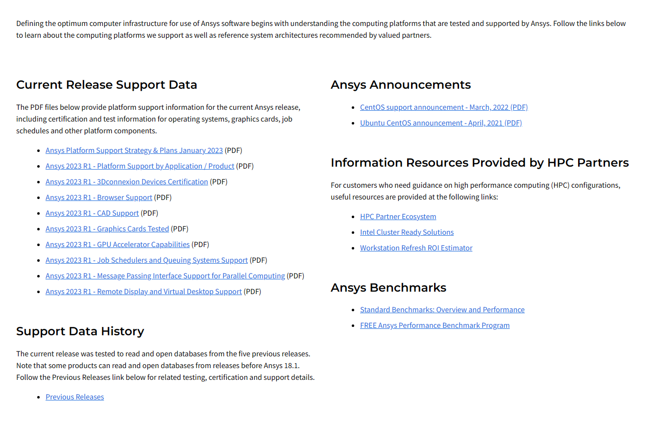

      Strictly speaking we don't support any Mac installation. Some of the software will work with the emulators, but as we don't test (or compile for) Mac OS it's difficult to say what will happen with the various codes & updates, Mac updates and emulator updates.  The Student code is Windows only, the "full" version(s) are Windows (10 & 11) and several flavours of Linux/Unix.
      https://www.ansys.com/it-solutions/platform-support  covers what is supported.

      Any information will be here   https://www.ansys.com/it-solutions/platform-support/previous-releases    Note, Student only exists for current and upto two previous releases. However, older versions of Ansys may not work well on Win11, so you may just find some new problems trying an older version.
