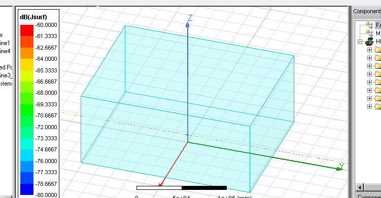

      Hi all,
      I am trying to excite two series transmission lines using a Lumped port in HFSS (As in the attached picture). So, there are two cylindrical conductors (transmission lines) on the two sides of a lumped port above PEC ground. The lines are open at their end. To avoid reflections, I want to use FE-BI on the air box around the structure. When I set this up, it gives me an error of "Solving frequency...(Domain solver), process hf3d error: Failure in solving the ports...Please contact Ansys technical support ". I would appreciate any help in this regard.
      Even without considering the bottom face of air region as PEC (assigning all faces as FE-BI), it gives the same error.
      Thanks.

      As per the explanation  given above for the model creation I couldn't find any issues with the simulation (without PEC ground). Just make sure couple of things below
      1. Check for the proper defining of FE-BI Boundary. The assignment should come under Project Manager
      2. I can see two Lumped RLC components in the attached figure. Validate those components. Where are they placed on the transmission line?
      3. Make sure you have enabled 'solve inside' for the FE-BI region and that not needed for transmission lines.

      Thank you so much for your time and help. I could solve the error when I subtracted the transmission lines from the air region. Not sure how it solved the problem though.
      I have another question. I want to simulate very long transmission lines in the mentioned configuration. So, to avoid increasing the simulation time, I want to use a small air box around the port, which includes a small part of the Tlines as well. Applying FEBI on the surface of the air box, and assigning Tlines that extend out of the box as IE regions. PEC boundary condition (infinite ground) is also applied to the bottom face of the air region. The simulation runs in this set up, but the results dont seem to be right. Is there anything wrong with the set up? because I have read that the current is continuous from FEM to IE region, so I think there is no problem in defining long Tlines in this way.
      Please find the picture attached,
      Thanks,

      Hello Bamdad,
      The best way to create a long transmission line in HFSS is to utilize the Deembedding feature in its Excitation. An example workflow below.
      For more information about modeling long transmission lines, see the Applications for Deembedding section in the Assign Excitation chapter in the HFSS online help document.
