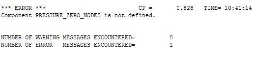

      hello i am a new ansys usser, i am learning lumbar motions simulations and i'm having aproblome like the one inthe picture
      is there some one wo can help me solve the problem ?

      Hi Hendrawan Ariefudin,
      It means the component Pressure_zero_nodes is not defined. Please follow the instruction video slowly, step by step.
      In the Names Selections check pressure_zero_nodes. And make sure you add APDL command on Analysis setting part
