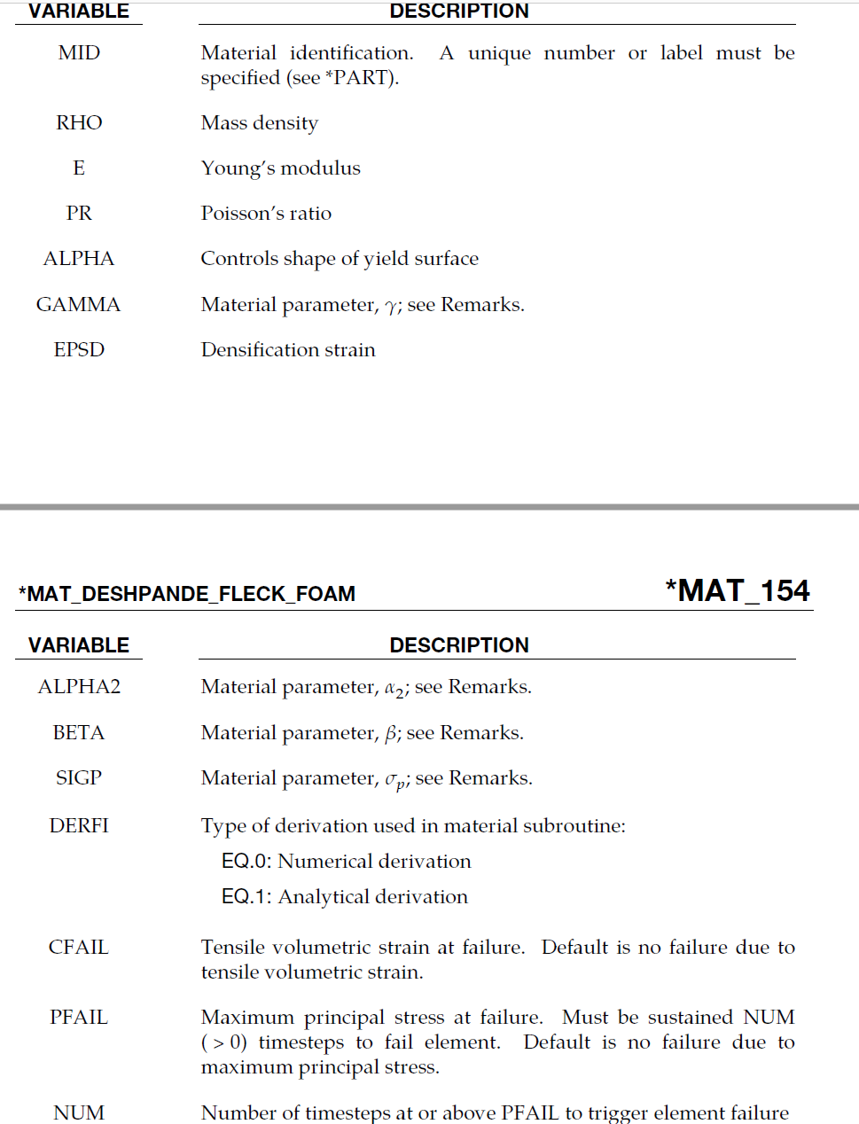

Subscriber"I am new to LS-DYNA and currently working on a compression test project for Infra Lightweight Concrete (ILC). To simulate this, I am using the mat154 material card. I have searched through several papers and the LS-DYNA manual, but I couldn't find the values for parameters such as alpha, beta, gamma, densification strain parameters, etc. It would be beneficial if someone could assist me with this."

Ansys EmployeeHello Dileep,
Please look at those journal/conference articles:
Reyes, Aase & Hopperstad, Odd & Berstad, Torodd & Hanssen, AG & Langseth, M. (2003). Constitutive modeling of aluminum foam including fracture and statistical variation of density. European Journal of Mechanics A/Solids. 22. 815-835. 10.1016/j.euromechsol.2003.08.001.
Reyes, Aase & Hopperstad, Odd & Langseth, M.. (2004). Aluminum foam-filled extrusions Subjected to oblique loading: experimental and numerical study. International Journal of Solids and Structures. 41. 1645-1675. 10.1016/j.ijsolstr.2003.09.053.
Szyniszewski, Smith, Arwade, Hajjar, Schafer. Tensile and Shear Element Erosion in Metal Foams. 12th International LS-DYNA Users Conference
If you are a commercial customer, please create a service request on the Ansys customer portal: customer.ansys.com and we will be able to look at this issue in more detail.
Let me know how it goes.
