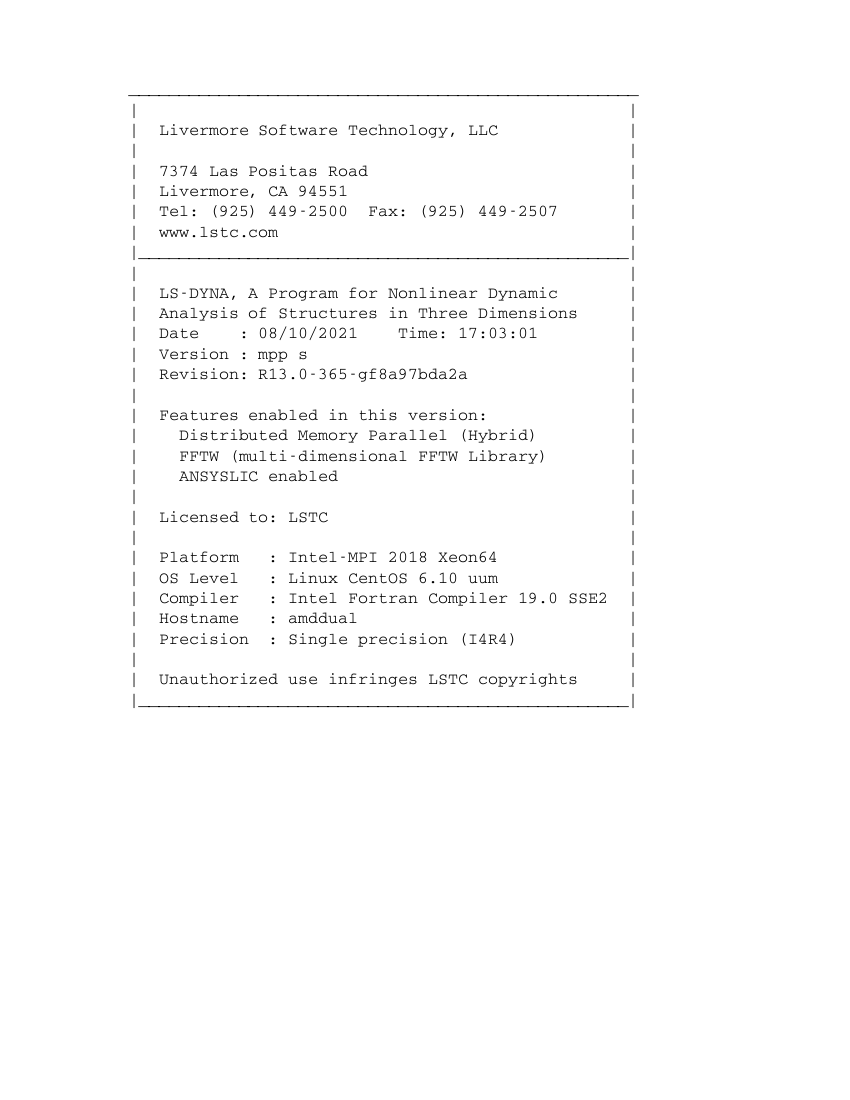

I've been running some fluid-structural interactions in LS-DYNA using the CESE module on the Gadi HPC in Australia. The system uses openMPI 4.1.1 and MPP Hybrid LS-DYNA 13.0.0. I've been having massive slow down issues when trying to run my simulation across multiple HPC nodes. If I run my problem on 48 cores (1 node) it begins virtually instantaneously whereas if I run it on more than 48 cores (multiple nodes) the start time often exceeds the wall time. The decomposition proceeds well but everything seems to grind to a halt after Phase 3. I've spoken to the HPC technical support team and they're not sure what the problem is, CPU usage is around 100% but there is very little communication between cluster nodes. I'm not sure if there's potentially an incompatibility between Dyna 13.0.0 and openMPI 4.1.1?
