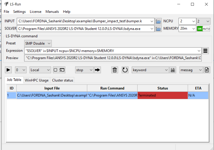

SubscriberI have recently downloaded Ansys LS Dyna student 2020 R12 version and used prepost, but I couldn't use LS run, as it shows the following error..
August 10, 2021 at 1:57 pmANSYS_MMadore
Forum ModeratorPlease try changing the License Type to "Node locked" and then browse to the license at C:\Program Files\ANSYS 2020R2 LS-DYNA Student 12.0.0\Shared Files\Licensing\student.lic. Please try running again.
August 10, 2021 at 2:10 pmAugust 10, 2021 at 2:12 pmANSYS_MMadore
Forum ModeratorPlease look at the lsrun.out.txt file which should be created. Can you share the complete contents?
August 10, 2021 at 2:12 pmAugust 10, 2021 at 2:15 pmANSYS_MMadore
Forum ModeratorLooking again, it appears the license you have has expired. Can you please download the latest copy of LS Dyna Student and install it? It will include the updated license file.

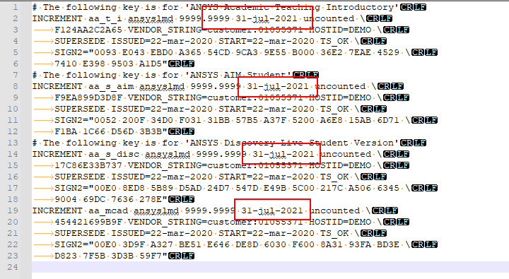

SubscriberWe have the same Problem here - after collecting the license debug information I have found that the license has expired:
The version is the currently available download:
We are planning to use the software for a student lesson this Friday. Could you provide us a new license file via E-Mail?
Thank you very much in advance.
Kind regards
Andre

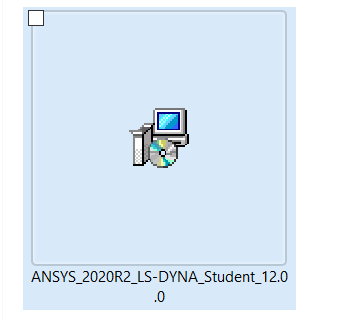

Forum ModeratorPlease try uninstalling, deleting C:\Program Files\ANSYS 2020R2 LS-DYNA Student 12.0.0, then download a fresh copy from the download page. This should include the new license file, which may not be updating automatically with just installing over the top of a previous install.
August 10, 2021 at 7:13 pmISF_Admins
SubscriberThank you very much for the quick and helpful reply Unfortunately the current download from
(https://ansys13.ansys.com/release2020R2/ANSYS_2020R2_LS-DYNA_Student_12.0.0.msi?_auth_=1628707120_e53f6c80da8f9de37c99fb610a2a28e3)
doesn't work with uninstalling, deleting the installation directory and new installation:
The license file you provided me via email does work though
August 10, 2021 at 7:16 pmANSYS_MMadore
Forum ModeratorThis is the current link for download.
https://ansys13.ansys.com/release2020R2/ANSYS_2020R2.1_LS-DYNA_Student_12.0.0.msi?_auth_=1628707584_df142f7a323334d63b3db23b6c782575
August 10, 2021 at 7:21 pmISF_Admins
SubscriberThanks again - this download did solve the issueAugust 11, 2021 at 8:29 amISF_Admins
