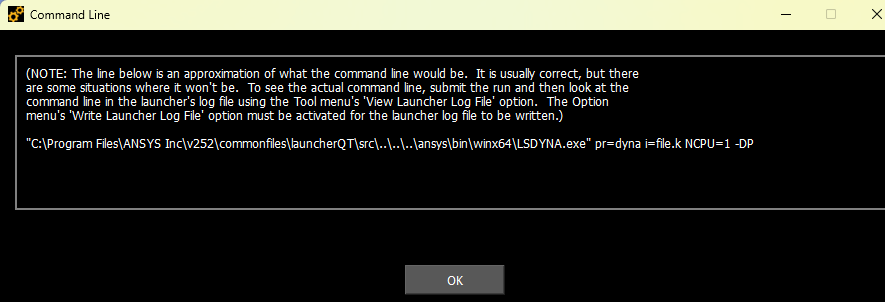

      I found the -DP flag by using the Mechanical APDL Product Launcher. You can set the simulation environment to "LS-DYNA Solver" and change the settings. For example, check the "Enable double precision analysis" box:
      Then, you can can click Tools > Display Command Line to get the command line:
      Reno.
