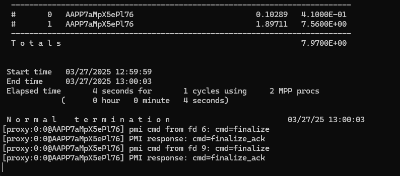

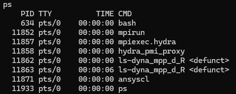

      Issue: LS-DYNA MPI processes hang and become ghost/defunct processes after a LS-DYNA simulation with normal and error termination. This prevents any subsequent programs from starting.

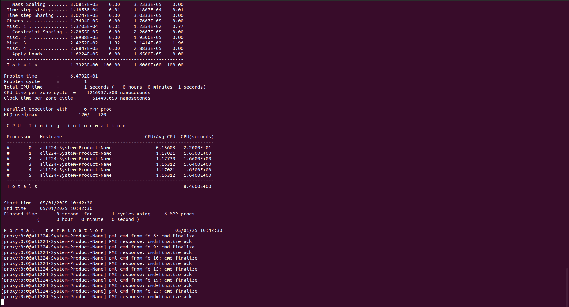

      • The issue is reproducible on WSL 2 with Ubuntu 22.04 and native Linux machines. (screenshots are attached for both configurations)
      • LS-DYNA processes become  when closing MPI processes.

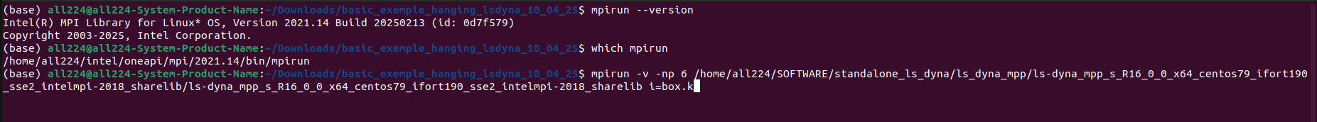

      • Using mpirun with the verbose flag (-v) shows the hanging processes.
      • The problem does not occur on WSL 1, which closes properly.

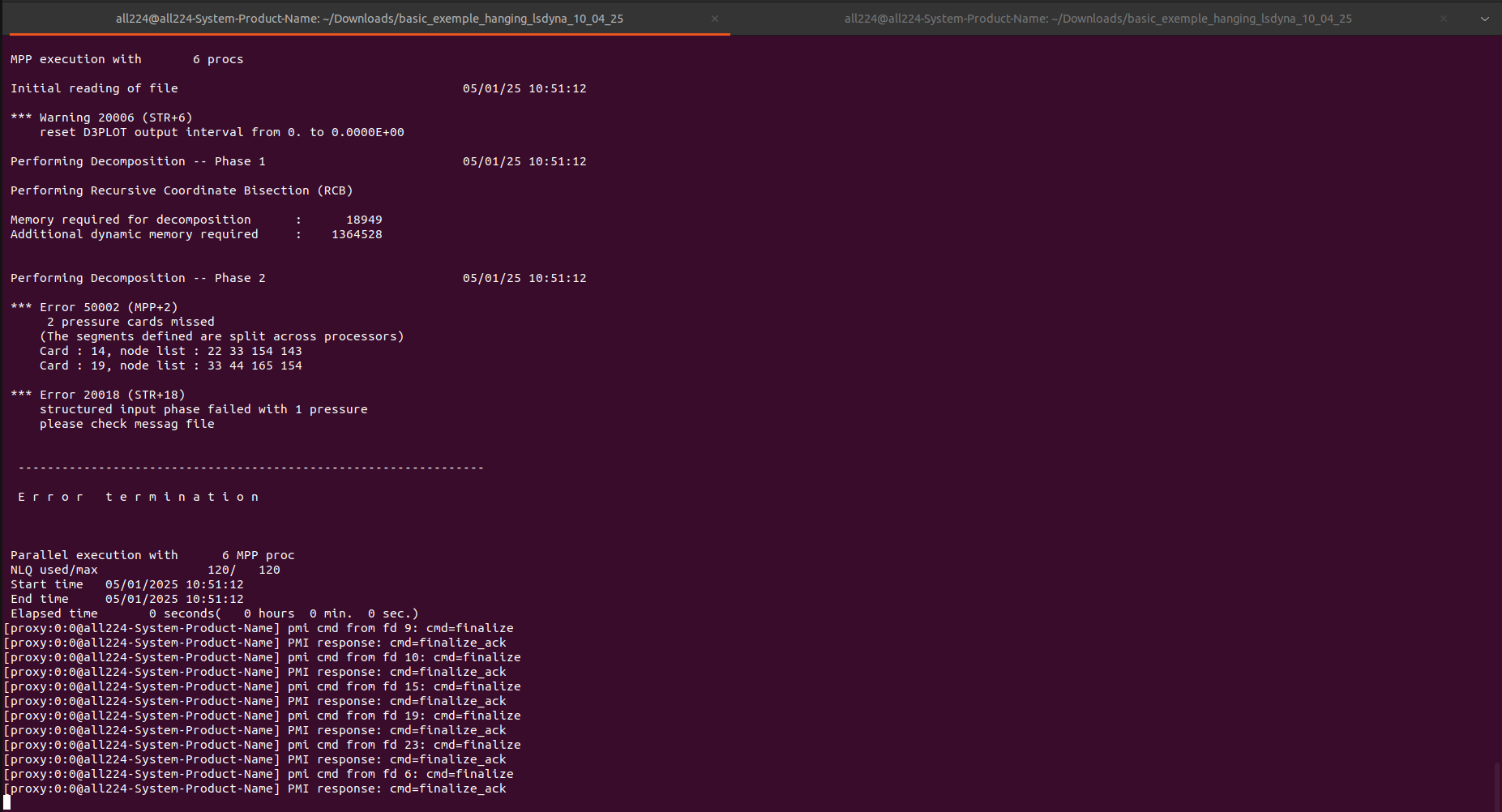

      • The issue also happens when I get an error termination

      mpirun command
      Hanging dyna normal termination
      hanging dyna error termination
