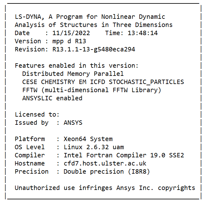

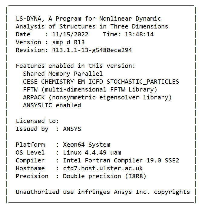

      LS Dyna banner for smp d and mpp d R13 version is shown below.
      SMP double precision

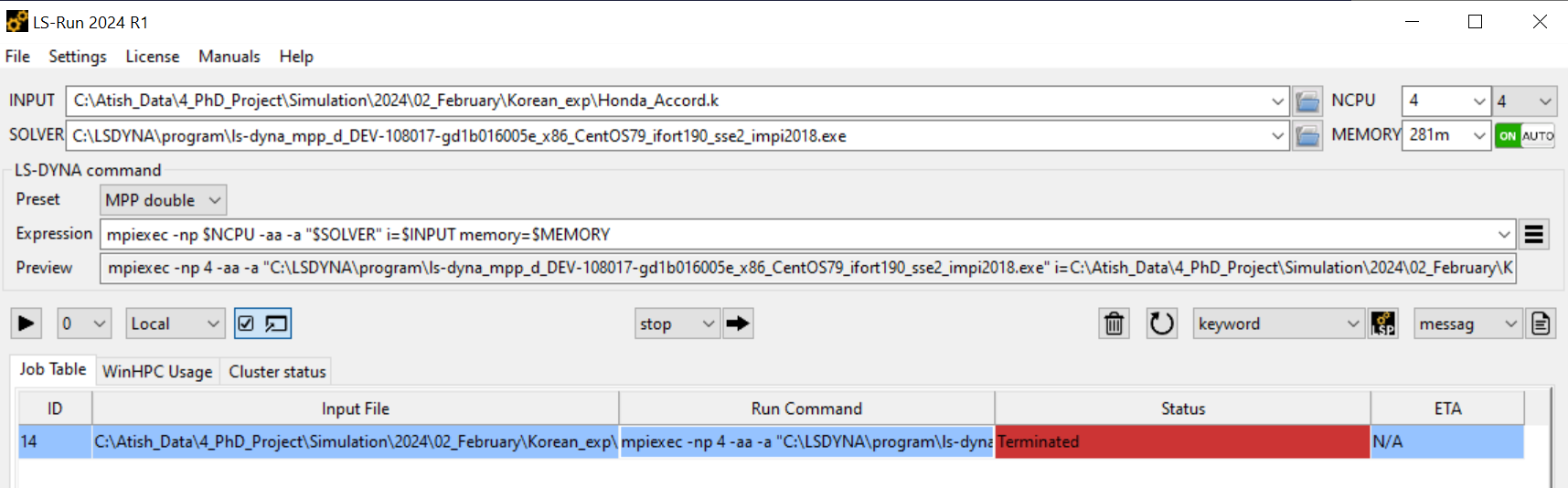

        I copied path to mpi file and getting error related to mpiexe. Am I missing anything in the solver path or expression?
        'mpiexec' is not recognized as an internal or external command.

    • Reno Genest
      Hello Atish,
      What error messge are you getting? Do you have Intel MPI installed on your machine? Try to point to the complete path for the mpiexec file:
      "C:\Program Files (x86)\Intel\oneAPI\mpi\2021.8.0\bin\mpiexec.exe" -np 4
      Let me know how it goes.
      Reno.

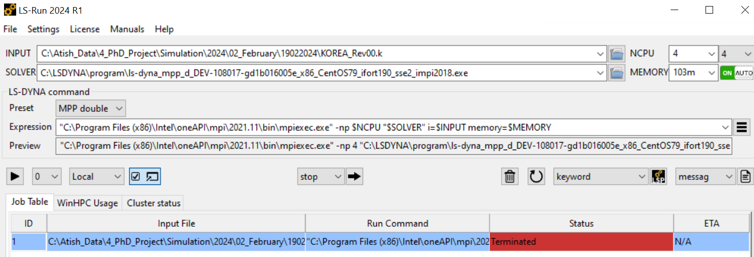

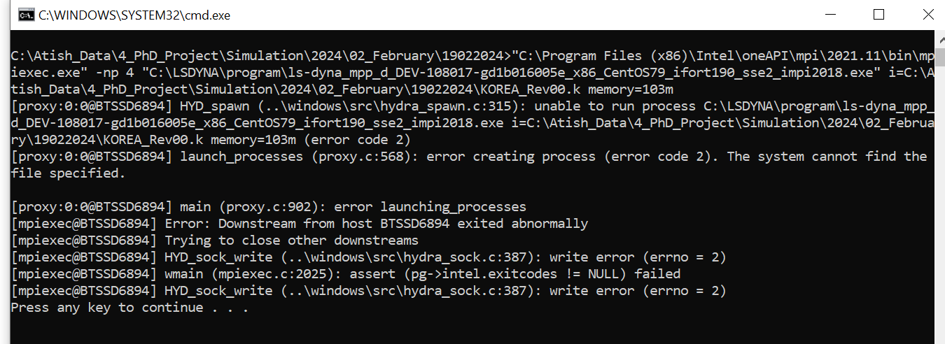

    • Atish Gawale
      Yes. I installed intel MPI on my machine. I am sharing LS run and errors described below.
      Atish

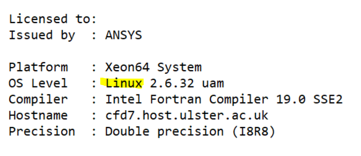

    • Reno Genest
      Hello Atish,
      You cannot run this LS-DYNA executable on Windows. The executable I sent  you is for Linux. Try on Linux and let me know how it goes.
      The LS-DYNA banner you sent me indicated a Linux OS and so this is why I sent you the Linux version of LS-DYNA.
      Reno.
