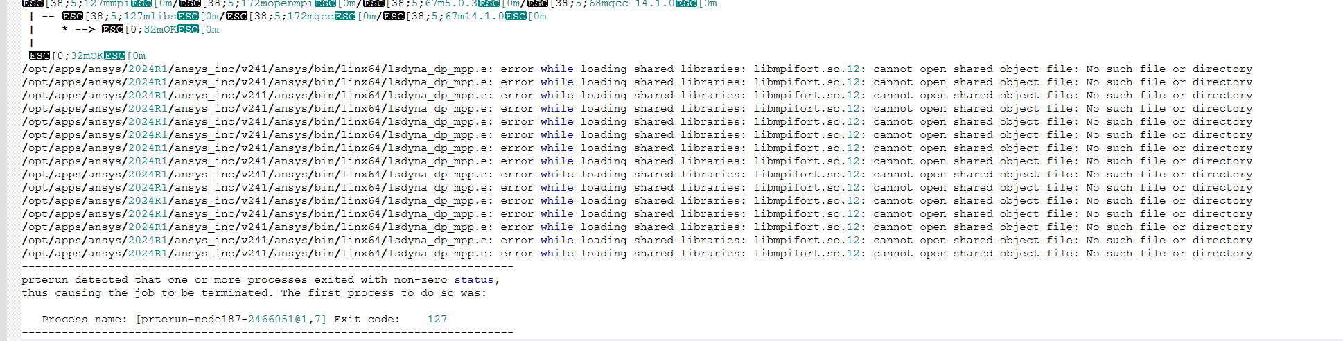

      I am running simulation using LS DYNA MPP on linux HPC and getting following error :
      Is anything wrong with my batch script?
      #!/bin/bash -l
      #SBATCH --job-name=tube
      #SBATCH --output=tube.out
      #SBATCH -N 1
      #SBATCH --ntasks-per-node=64
      ##SBATCH -p k2-hipri
      ##SBATCH --time 0-00:05:00
      #SBATCH --mem-per-cpu=2G
      #SBATCH --partition k2-hysafer
      ####SBATCH --exclusive     # Instructs SLURM to not run any other job in the node(s) selected
      module load mpi/openmpi
      export ANSYSLI_SERVERS=2325@193.61.145.219
      export ANSYSLMD_LICENSE_FILE=1055@193.61.145.219
      export LD_LIBRARY_PATH=$LD_LIBRARY_PATH:/opt/apps/ansys/2024R1/ansys_inc/v241/commonfiles/MPI/OpenMPI/4.0.5/linx64/lib/
      export PATH=$PATH:/opt/apps/ansys/2024R1/ansys_inc/v241/commonfiles/MPI/OpenMPI/4.0.5/linx64/bin/mpirun
      unset SLURM_GTIDS
      export LSTC_LICENSE=ansys
      mpirun -np 64 /opt/apps/ansys/2024R1/ansys_inc/v241/ansys/bin/linx64/lsdyna_dp_mpp.e i=tube.k memory=999m
      Atish
    • Alex R.
      Hello Atish,
      Could you please verify that lsdyna_dp_mpp.e in your ansys folder is a version of ls-dyna compiled form OpenMPI? Or could you download the ls-dyna for OpenMPI from here https://ftp.lstc.com/user/download_page.html (username: user ; password: computer), upload it to your server and try it?

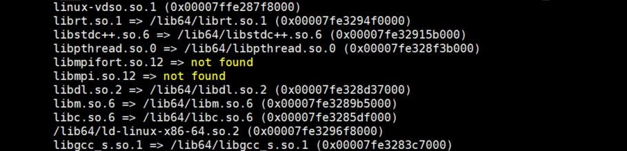

      Could you please check if you have all dynamically linked libraries for lsdyna_dp_mpp.e. Please run this on your cluster:
      ldd  /opt/apps/ansys/2024R1/ansys_inc/v241/ansys/bin/linx64/lsdyna_dp_mpp.e

    • Atish Gawale
      Thank you Alex,
      See below outcome of ldd command. I think some files seems to be missing.
      I also downloaded the following files from the LSTC website. Could you please instruct the procedure to install  following OpenMPI files on linux?
      ls-dyna_mpp_d_R15_0_2_x64_centos79_ifort190_sse2_openmpi405.tgz_extractor.sh
      ls-dyna_mpp_d_R15_0_2_x64_centos79_ifort190_sse2_openmpi405_sharelib.tar.gz_extractor.sh
      Atish
    • Alex R.
      Hello Atish,
      Please unpack the files and upload them to your server. The solver is already executable, so no installation is needed. However, you may need to adjust the file permissions to allow execution.
