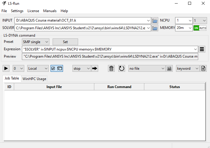

SubscriberHi, I'm trying to run a .k file on LS-RUN, and I'm encountering the attached error. I got the solver from ANSYS student version.
However, LS-DYNA is not appearing in the Analysis Systems on ANSYS WB. Please help :)

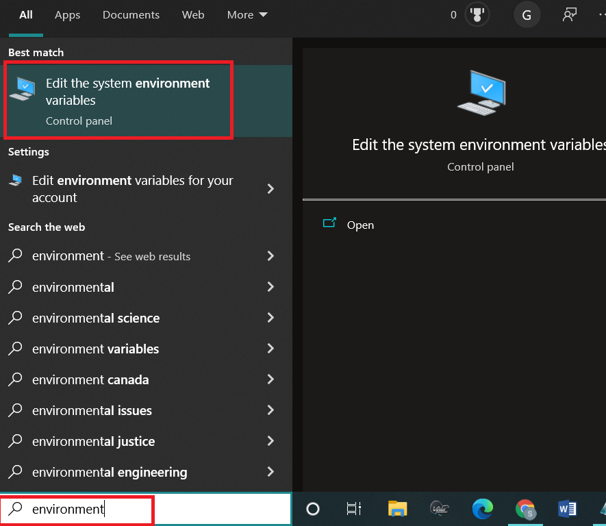

Ansys EmployeeIn the Windows search field on the task bar, type in Environment

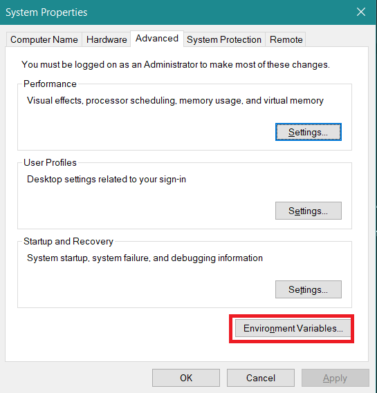

Open "Edit System Environment Variable for your system"

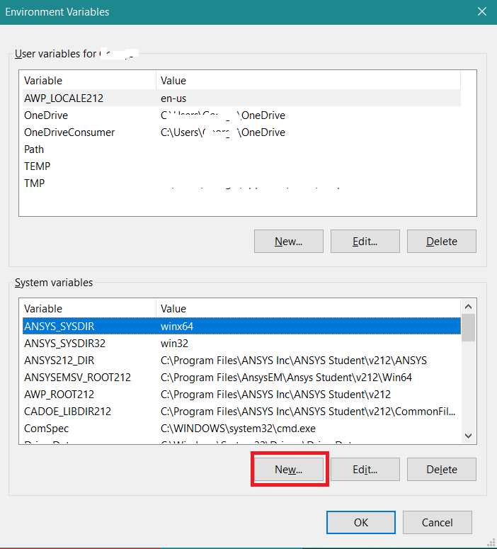

Click on Enironment Variables:

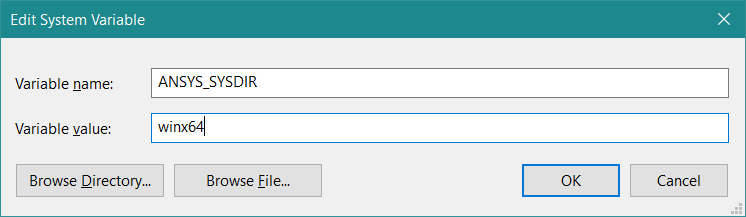

Click on New and Add the System Variable: ANSYS_SYSDIR
Now try to run LSRUN

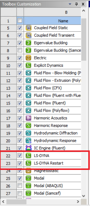

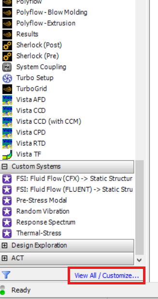

For available in WB: If you click on View All/Customize
Is LS-DYNA available?
