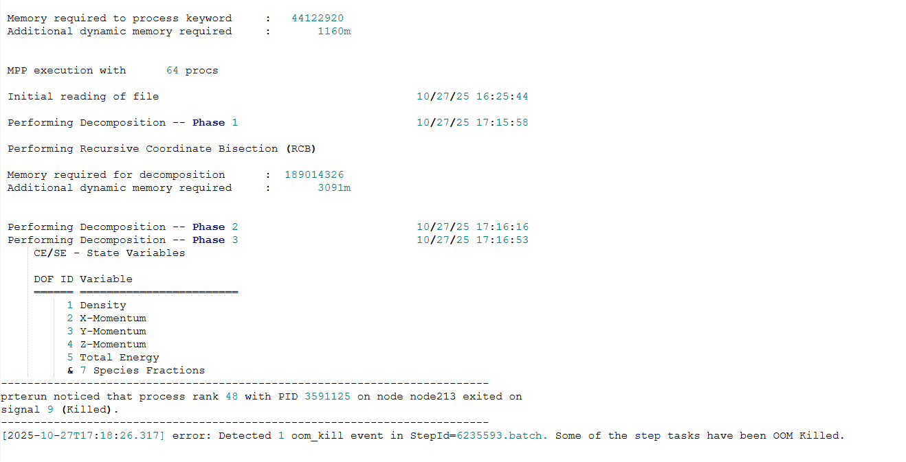

October 30, 2025 at 6:48 amigandiko Ansys EmployeeHello, do you see an error in any of the mes00* files? You may have to check all mes00* files. If you're running the job on a cluster, please also check if there is a better error message in cluster log (usually .e or .o files). Since the error seems to occur duing model decomposition, as a test, please try to run the job with 1 MPP rank (-np 1).
