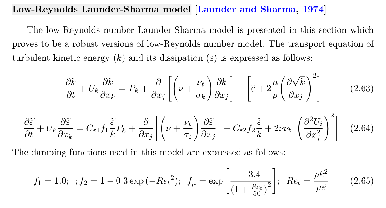

SubscriberThe original Launder Sharma Low Reynolds number Turbulence model isÂ

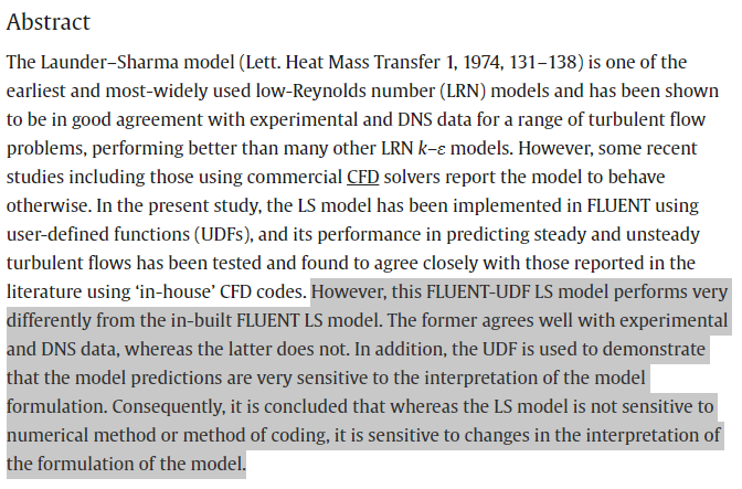

However the , the paper "https://www.sciencedirect.com/science/article/pii/S0045793013000820" mentioned that the implementation of the Low-Reynolds Launder-Sharma model in Ansys Fluent is not correct.Â

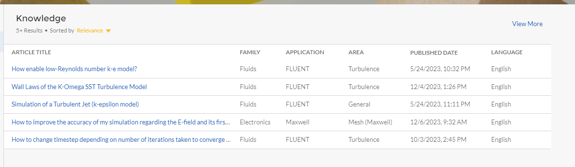

Unfortunately neither Fluent theory guide or knowledge database has any documentation regarding the formulation of Low Re launder Sharma model in Fluent.

Forum ModeratorIt looks like even the model index has been removed from the solver, so staff are unable comment on your question. I'm fairly sure they're for the k-e models though, Fluent didn't have k-w when they were in the manual(s).Â

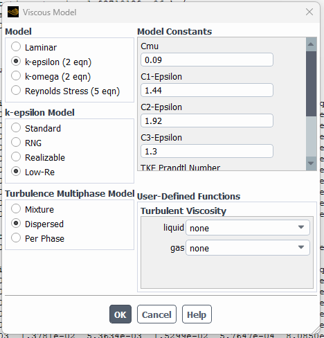

SubscriberAs an alternative approach, can you provide a minimal working example for disabling the wall functions for standard K-epsilon model. In the stanard K-Epsilon model one can alter the damping terms to redefine the Low-reynolds number K -Epsilon model when wall functions are off.Â

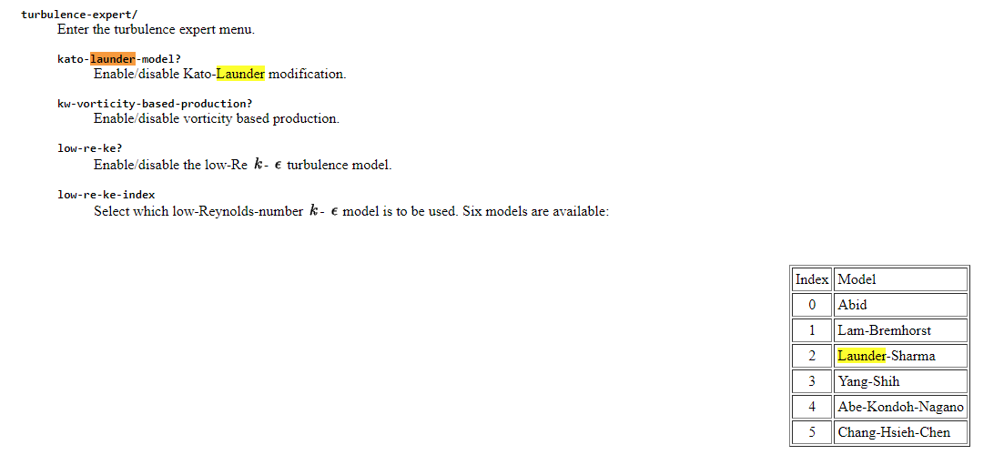

Forum ModeratorThat's a different model - clicking on Help ought to show up the documentation. The Launder-Sharma option (and a few others) is TUI only, and wasn't added to the GUI.Â
I'm checking on what can be shared, but I suspect the best I can do is add it to the Portal side of things. I have a copy, but only because I've been here long enough to have to had support the option when it was "new": it's also marked internal only so can't share that version.Â

Forum ModeratorThere isn't any additional documentation, and the models are unsupported - use with caution.Â
