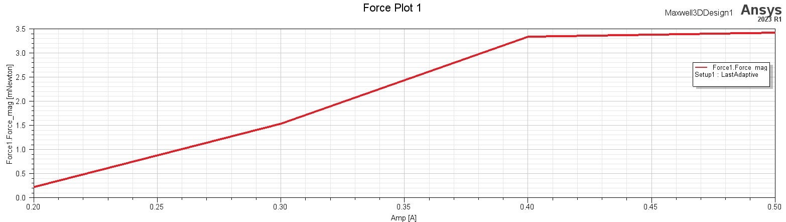

SubscriberI've been performing magnetostatic analysis on a 4-pole active magnetic bearing of stator made up of iron and copper coil with 250 turns. Excitation is given as Amp*Turns, where the Amp rating is 0.5A. The virtual Force model is solved with parametric analysis of varying currents from 0.2 to 0.5.
The calculated force should come to around 9 Newton but it is on the scale of 0.5-3.5 milliNewton.
