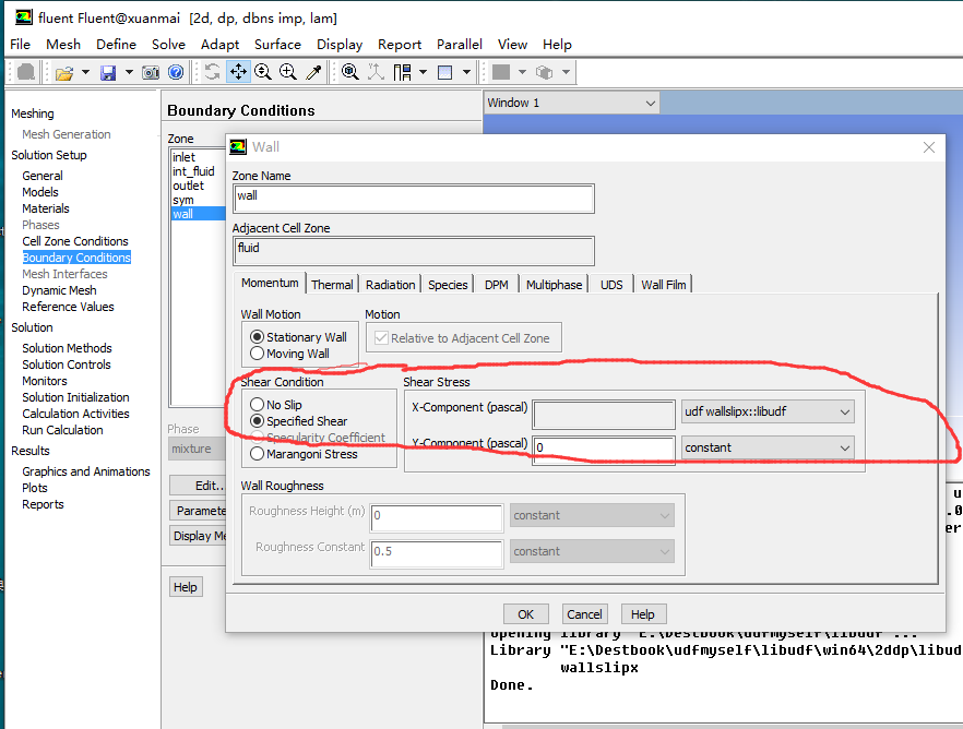

SubscriberRecently, I was simulating the nozzle with high kn number. Originally, I wanted to write UDF, but I see that some people say that the effect of low pressure boundary slip is very good.
But low pressure boundary slip is like only works in 3D. How can I open this button in 2D?

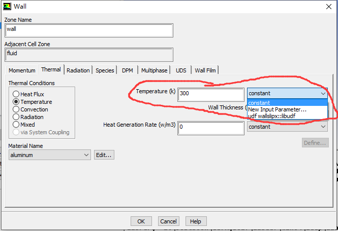

It seems that we can only use UDF to solve this problem, but I have a question. I can load the UDF of Velocity slip on the specific shear. Where is the UDF of temperature jump  loaded?nn
January 13, 2021 at 12:14 pmzhangdongjie
SubscriberIs not implemented but you can code it on your own./forum/discussion/comment/102901#Comment_102901
January 13, 2021 at 12:15 pmRob
Forum ModeratorThermal tab, you should be able to attach it where it says constant in the above. nJanuary 16, 2021 at 6:31 amzhangdongjie
SubscriberThermal tab, you should be able to attach it where it says constant in the above./forum/discussion/comment/102922#Comment_102922
Hello, excuse me, is the UDF of temperature jump loaded here?n
January 18, 2021 at 9:26 amAmine Ben Hadj Ali
Ansys EmployeeI guess for that you require a DEFINE_HEAT_FLUX Macro or just use Pressure Based Solver and not using Density Based Solver. Is there any reason why you want to use DBS?nJanuary 18, 2021 at 11:52 amzhangdongjie
