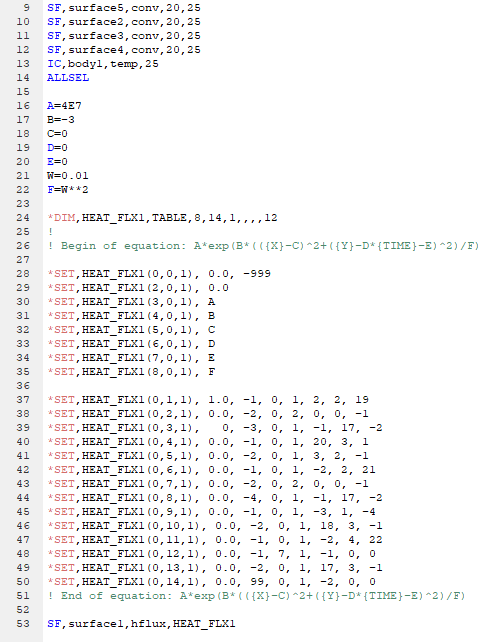

SubscriberHello everyone, I want to apply the convection boundary condition via the SF command:
SF,surface5,conv,20,25
SF,surface2,conv,20,25
SF,surface3,conv,20,25
SF,surface4,conv,20,25
IC,body1,temp,25
ALLSEL

November 29, 2021 at 7:56 pmEvgenii_K
SubscriberHi Erik, The mistake was in the Named Selections name.
I worked on a scenario in which I wanted to implement Goldak's model - this model is used to simulate swaki and as a test problem I decided to implement a simpler one - a Gaussian distribution model in which I made a mistake, the correct scenario looks like this:
This script is freely available.
I will return to the GoldakÔÇÖs model later and create a separate topic for discussion, I think there will be many interesting things.
