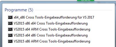

DrAmine
Ansys Employee open the x-86_x64 Cross Tools Command Prompt. Make sure it is x-64 and type cl to check if the installation was correct.

DrAmine
Ansys EmployeeI have downloaded the same package and it is working fine. Just start Fluent from the cross command prompt and try to compile the UDF there. If it is not working I will suggest that you contact your IT.Â
