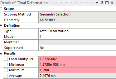

I did an Eigenvalue Buckling analysis and the resulting load multiplier is very small; it is 1.272e-002. What does it mean when you get a very small load multiplier, and what does the pink highlight mean in the "Details" box (as seen in photo below)?

SubscriberBuckling Load = Load Multiplier * Applied Load
If you change your applied load to this value and solve buckling again, the new Load Multiplier will be close to 1.0
The other two values in the pink area are the minimum and maximum deformation in the plot.
