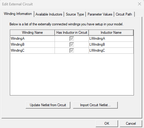

s_zanjani2004
SubscriberHi,
How can I link my circuit to the terminals ?
Many thanks
September 10, 2025 at 3:43 pm
GLUO
Ansys EmployeeHello,
You can assin winding terminal to the terminal, right click excitations to add winding, add winding to the terminal, choose external as the type of the winding. Then, you can right click excitation>>External circui>>Edit external circuit to create one. After you finished the circuit, save the netlist, go to the same window>>Import netlist.

s_zanjani2004
SubscriberHi,
Thank you but i can not find Groung for my circuit

GLUO
Ansys EmployeeSorry for late reply. After finishing the MaxCircuit, in project manager, you can right click the MaxCircuit design>>export to save it .sph file. Then, you can right click excitation>>External circui>>Edit external circuit>>Import netlist.

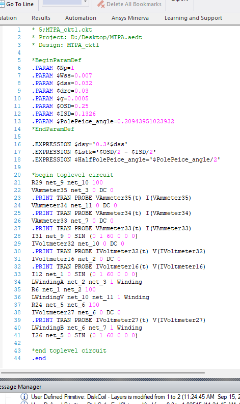

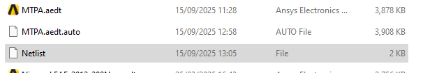

September 25, 2025 at 8:45 am
s_zanjani2004
SubscriberHi,
Thank you for the reply.
I have already done all of them but maxwell is not reading the values from the circuit. It is still considering the values from the project manager.

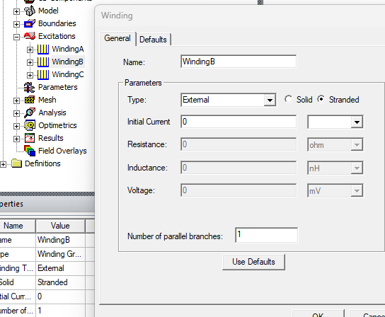

GLUO
Ansys EmployeeHi,
Did you change the winding excitation type from current/voltage to external?
GL
September 25, 2025 at 2:58 pm
September 25, 2025 at 3:11 pm
GLUO
Ansys EmployeeIn project manager, if you double click your windings, they should pop up the properties window, and the type need to be external. Everything elese is grayed out other than initial current. Could you double check that?

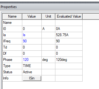

GLUO
Ansys EmployeeI think you are all set. What value it is using? Since project manager does not have any value now.
September 25, 2025 at 3:33 pm
September 25, 2025 at 6:11 pm
GLUO
Ansys EmployeeWhere is this one from?
September 25, 2025 at 6:37 pm
September 25, 2025 at 10:18 pm
GLUO
Ansys EmployeeSorry I am a bit confused. Isn't the ISin source you show in the first picture your desired excitation? Since it is the exciation in your external circuit, and you would like Maxwell to use this circuit?
