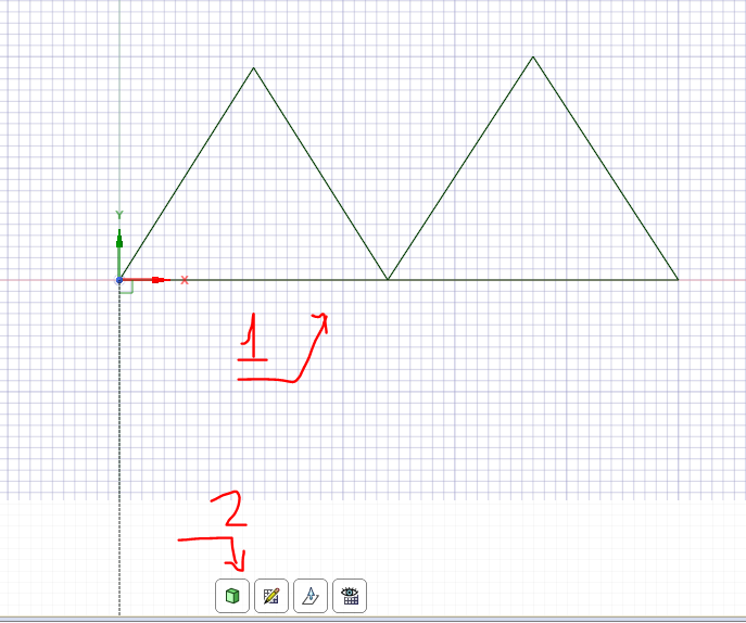

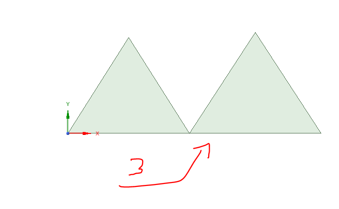

      How to make line sketch in spaceclaim? After making line sketch (1), I choose Return to 3D model (2), some area will be surface. But I want to make line only (to model truss) Can anybody give me some suggestions? Thanks in advance
    • Subashni Ravichandran
      Hi    thanhtt You can check the "create layout curves" in the "options" panel to create lines without making surfaces.
