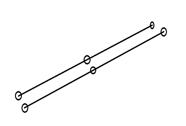

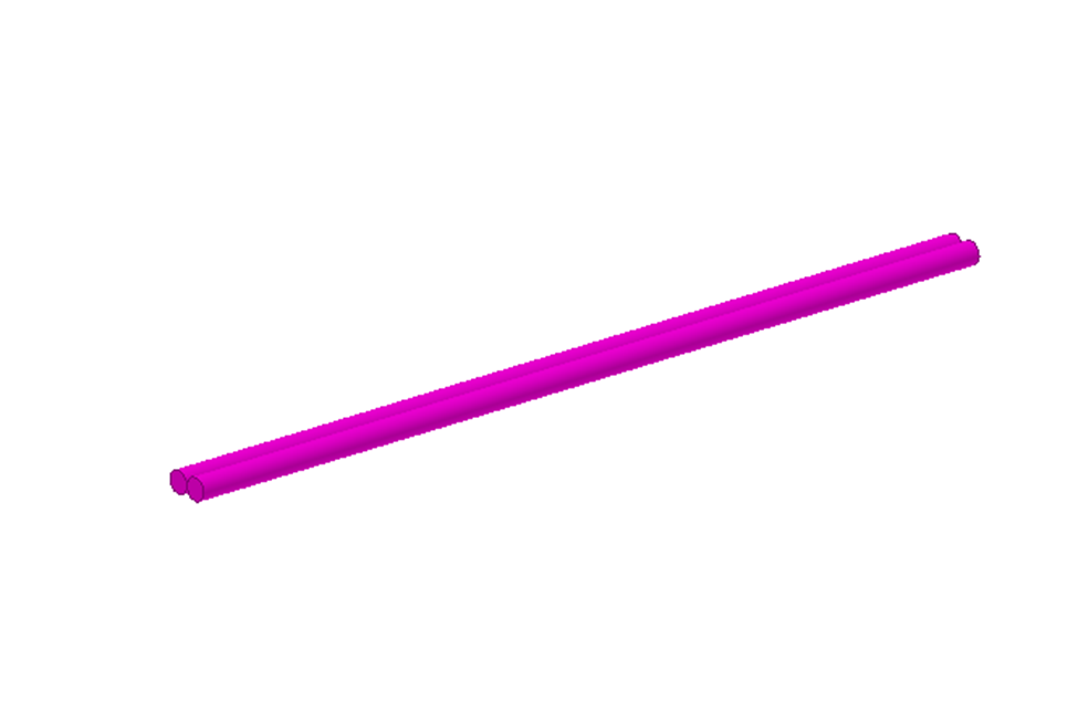

If, as an example, if we were looking at two circular beams next to each other,
idealised as two lines, meshed with a start middle and end node.
For this, what are the target segments?

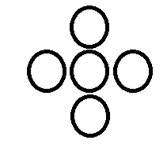

Are they along the length of the beam? Is it splitting the cross section up into x number of segments? Is it stating that essentially it is only tracking the number of adjacent beams to each node, so 1 would be fine here, but if there was beams above below and to left and right of a beam (in a cross arrangement such as shown on end view below) then 4 would be required?
or are the segments something different entirely? -

Ansys EmployeeWhen we create a contact, some elements are created with them (target and contact elements). In the Documentation I attached, it says for example: “ In a pair-based contact definition, the 3D line contact elements (CONTA177) are associated with 3D target segment elements (TARGE170)”. So, in my understanding, the segments are the elements.

Continuning the example above where I have two lines with the same sizing controls on them, one whole line scoped as contact and the other as target. For a given node on the target line I can imagine that it is proximity to 1 contact line and maybe 2 contact elements / segments. So if I select 8, what is it doing differently to if I select a 1 or 4?
Assuming that we then add three other lines around that original target line (forming that cross shape when looking at the end) and they are also all scoped as contact. The original target line now is target to 4 pairs of contact. How is that now being dealt with?
