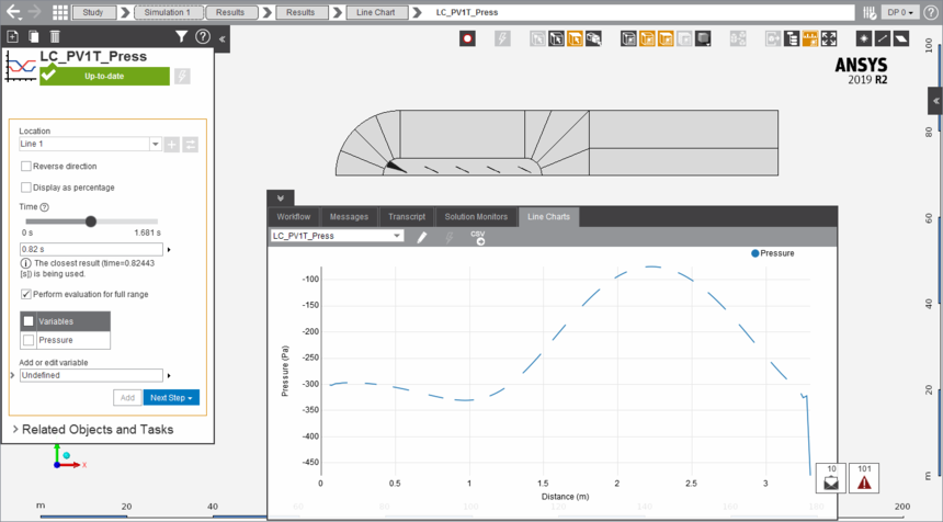

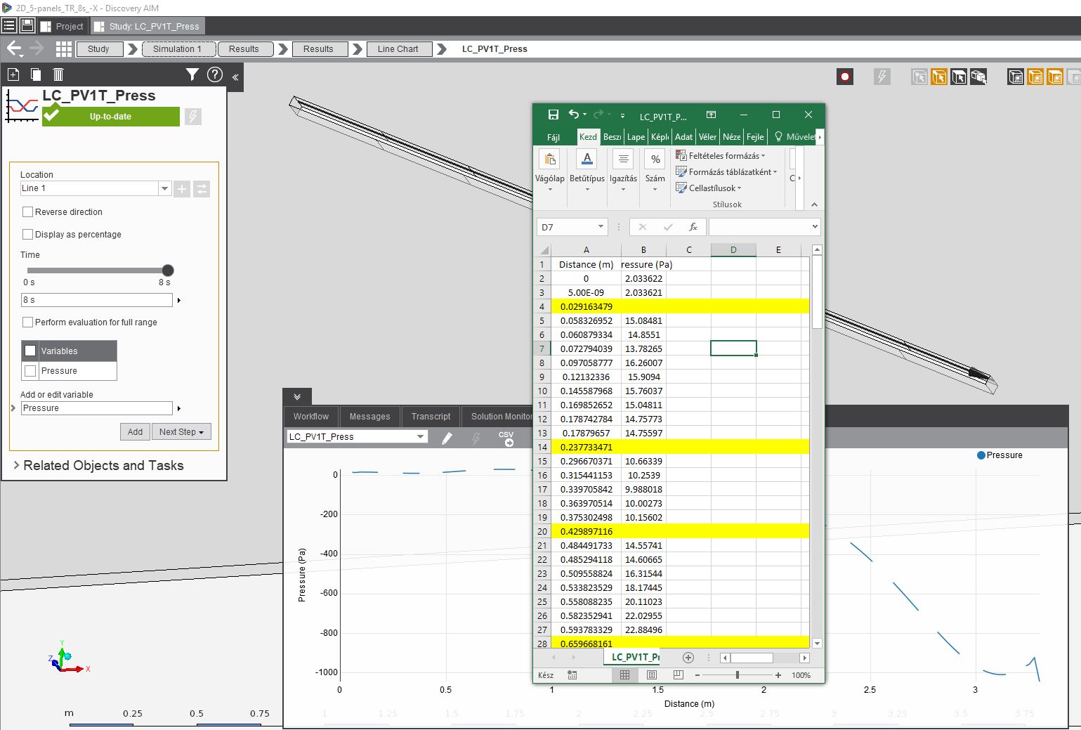

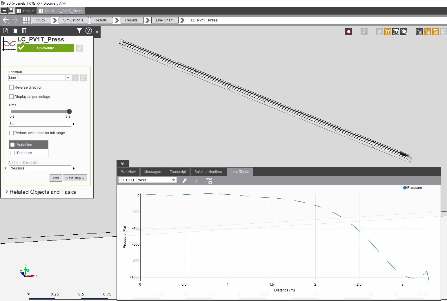

I am working on a CFD study in AIM of extracting the pressure forces on the surfaces of solar panels under different layout arrangements.
This is a quasi-2d transient setup which in every aspect worked fine so far (e.g. I was able to get Contour plots, Calculated Values etc.), but once I try to extract e.g. the pressure on the top surface of the 1st panel using 'Line Chart' feature I get a 'dashed' representation - see attached image. I did not have problem with it, I thought this is only a representation, but once I export the chart to CSV file and open it on Ecxel I can see that there are values missing for some locations - see the attached image with Excel (yellow lines).
I also attached a link for the archive file w/out results: https://we.tl/t-bffEY9IjLP
Can you please what's the reason for this?
steelxpert
🛈 This post originally contained file attachments which have been removed in compliance with the updated Ansys Learning Forum Terms & Conditions -
August 7, 2019 at 8:19 am
Naresh Patre

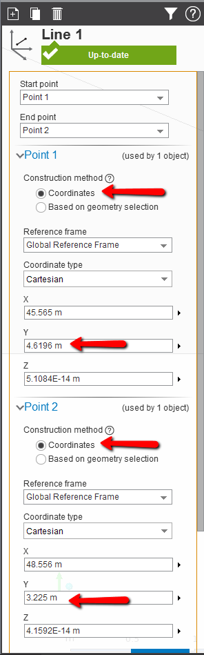

Ansys EmployeeHello steelxpert

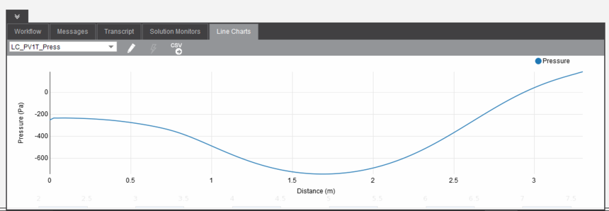

If you slightly move the construction line within the domain, you will get a continuous line chart. Go to Line geometry and change the Construction method to "Coordinates" and slightly increase the Y coordinate value. For instance, change the Y coordinate value of point 1 from 4.6195m to 4.6196m and the Y coordinate value of point 2 from 3.2249m to 3.225m. See below image showing these changed values and the corresponding line chart plotted for this updated line position. Note that the solution was partially solved only to display the line chart.

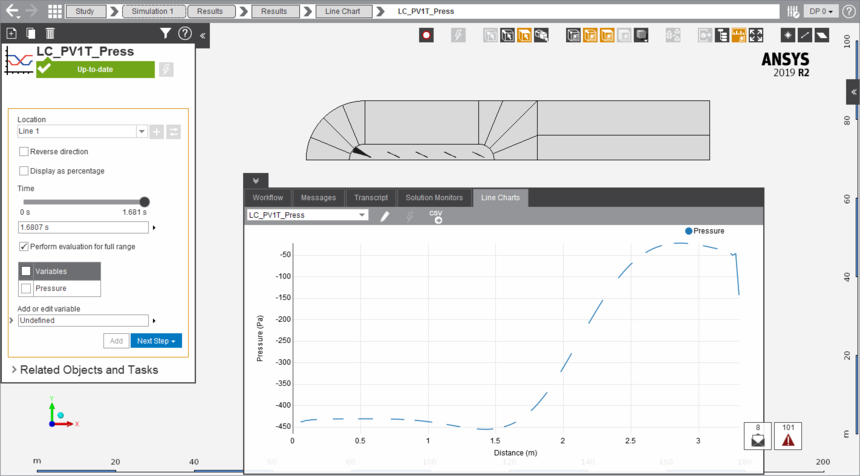

Regarding point 1 (discontinued line chart), I have submitted bug 153401 for this issue.
Regarding point 2, I partially solved the model and upon updating the Line chart (with Perform evaluation for full range' enabled), I am seeing different results at different slider position. Please see a couple of snapshots below showing the line chart at 2 different timings. Can you again cross-check at your end?

Ansys Employee steelxpert Please find attached a sample script which exports line chart in csv format for each time interval. Â
September 20, 2019 at 2:03 pm
info
SubscriberThank you Naresh Patre
I've already tried it and it worked nice.
