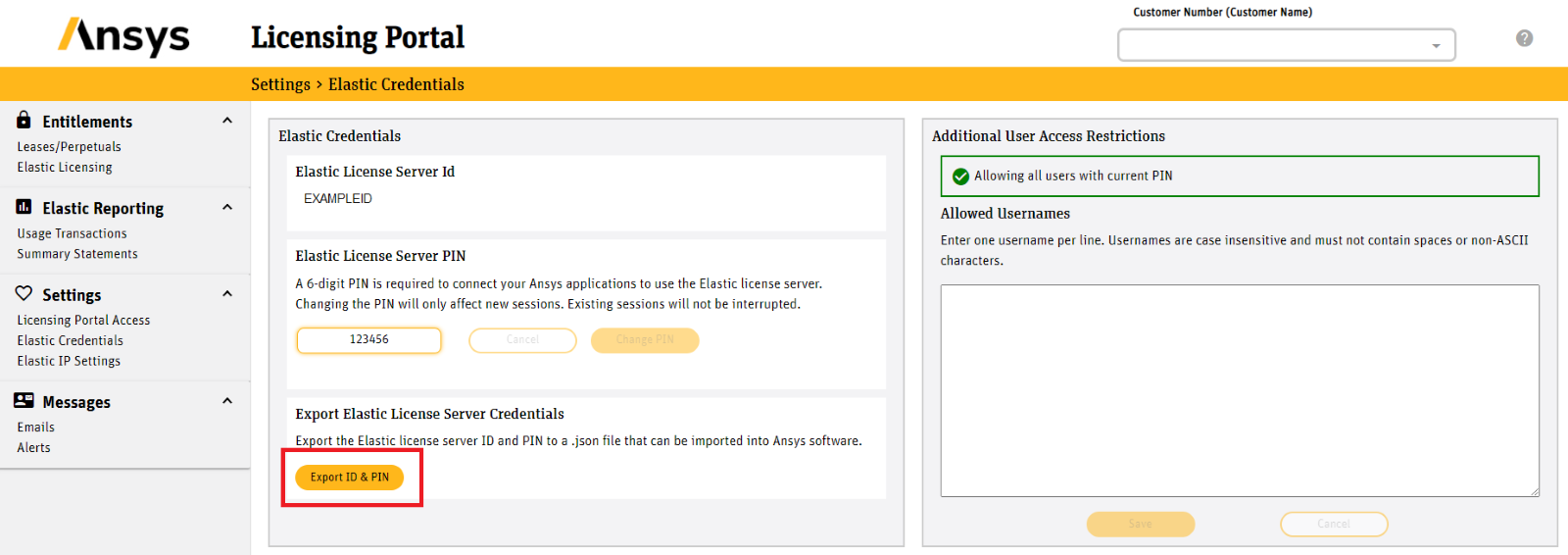

      An ASC for the company will be able to access the Ansys Licensing Portal (https://licensing.ansys.com/index.html#/clscredentials) to configure the Elastic Credentials. The ASC will set an Elastic License Server PIN and then Export ID & PIN. This ID and PIN will be used to specify the Elastic Licensing when creating a new resource in Ansys Gateway Powered by AWS. It can also be used to import to Client Licensing Settings within a VM session.

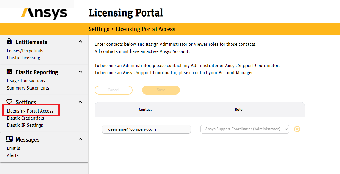

      To see who has access to configure the elastic settings you will want to look at the Licensing Portal Access page (https://licensing.ansys.com/index.html#/portalaccess). You will see a list of contacts who are ‘Ansys Support Coordinator (Administrator)’, ‘Licensing Portal Administrator’ and ‘Licensing Portal Viewer’. The 2 Administrators will have the ability to modify the credentials, while the Viewer will only have Read access.

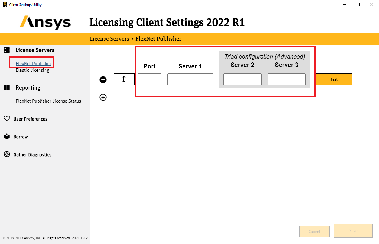

      Setting On-Prem Server within Client Licensing Settings – the user will need to specify the license server port and server hostname in the appropriate fields.

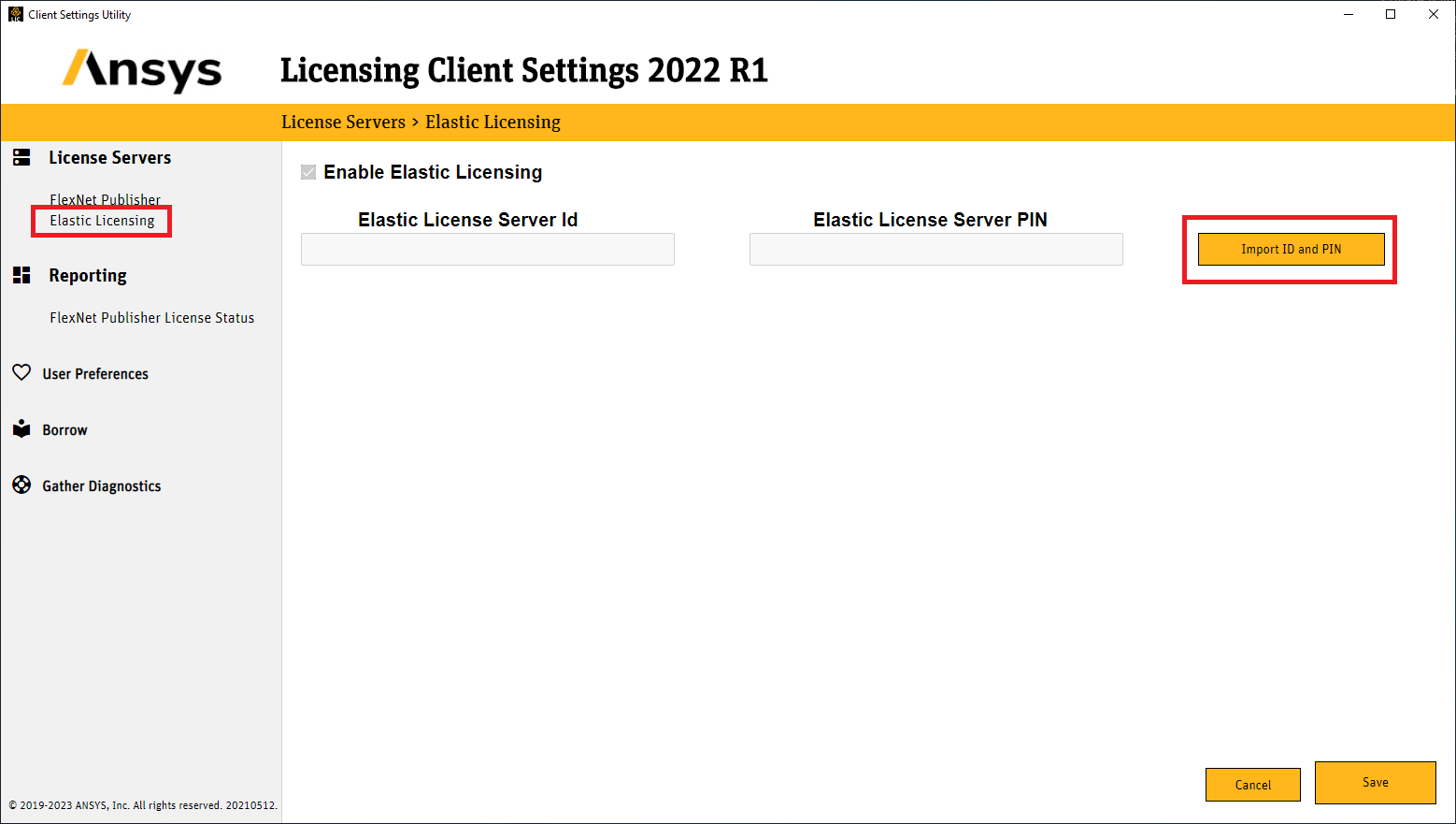

      Setting Elastic licensing within Client Licensing Settings – the user will need to import the elastic licensing server ID and PIN. This is exported from the Licensing Portal as noted in the section “Connecting to Ansys Elastic Licensing”.

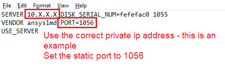

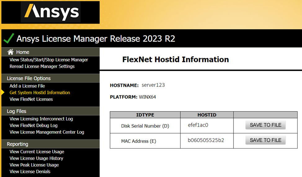

      To address above issue, Ansys License Manager should be configured to use private IP address instead of hostname. Before using the license file to setup Ansys License Manager, ensure that the private IP address of the server hosting the Ansys License Manager is used.
      1. Using the hostname as shown in Ansys License Manager below will not work due to the hostname resolution issue mentioned above. Use private IP address.
      1. When you receive your license file you will need to edit the file to replace the server hostname with the private ip addres of the license server.
      2. You  will also need to add the static port for ansyslmd by adding PORT=1056 on the SERVER line.
