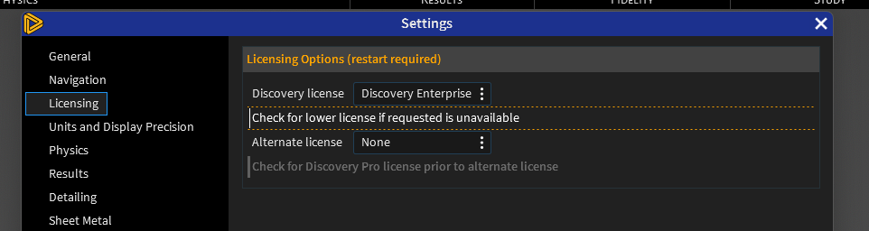

Can you launch Discovery> File> Settings> License and share screenshot of it.
January 8, 2026 at 1:19 pm
January 8, 2026 at 1:51 pm
Rajeshwari Jadhav
Forum ModeratorMay I know if you have a shared web license or floating licenses for Discovery?
January 8, 2026 at 1:56 pm
paul pladet
SubscriberI am running both, but have set the priority to floating in the licensing settings.

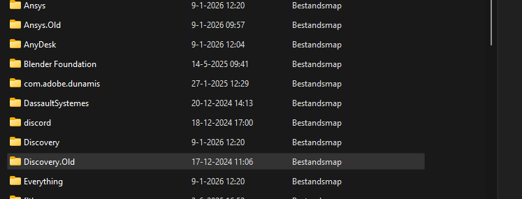

It's working for me with Discovery Enterprise license only, please rename the Discovery and Ansys folder under %appdata% to Discovery.old and Ansys.old.

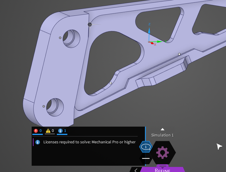

SubscriberHi Rajeshwar,
We cannot escalate this threw the Account Manager cause we dont have access for it or if we have access for it, we dont know how.
Please a solution under this topic or contact us directly: Support@aesc.nl
January 15, 2026 at 9:56 am
Tim Dukes
SubscriberHi Ben, Mech Pro or higher and CFD Pro or higher is now needed to use the 'refine' mode. Discovery enterprise only gives access to Explore Mode + Live GX solver in the refine mode for certain things.
