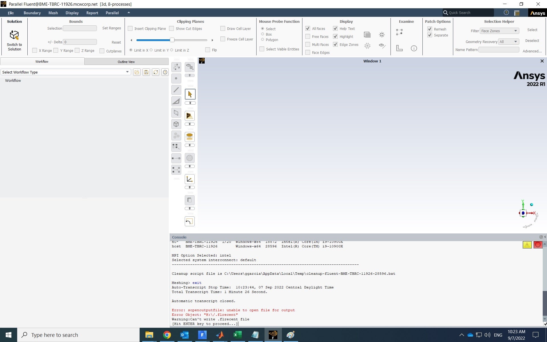

      Perhaps, this may give you a clue... I can open Fluent 2022R1, but every time I close Fluent it gives the following error message:
      Error: sopenoutputfile: unable to open file for output
      Error Object: "H:\/.flrecent"
      Warning: Can't write .flrecent file

      The IT person at my institution found a solution to my license problem. The solution was to enter the server IP address on the file "hosts" located at C:\Windows\System32\drivers\etc
      The problem of Fluent being unable to write the .flrecent file persists. However, I can now open Workbench.
