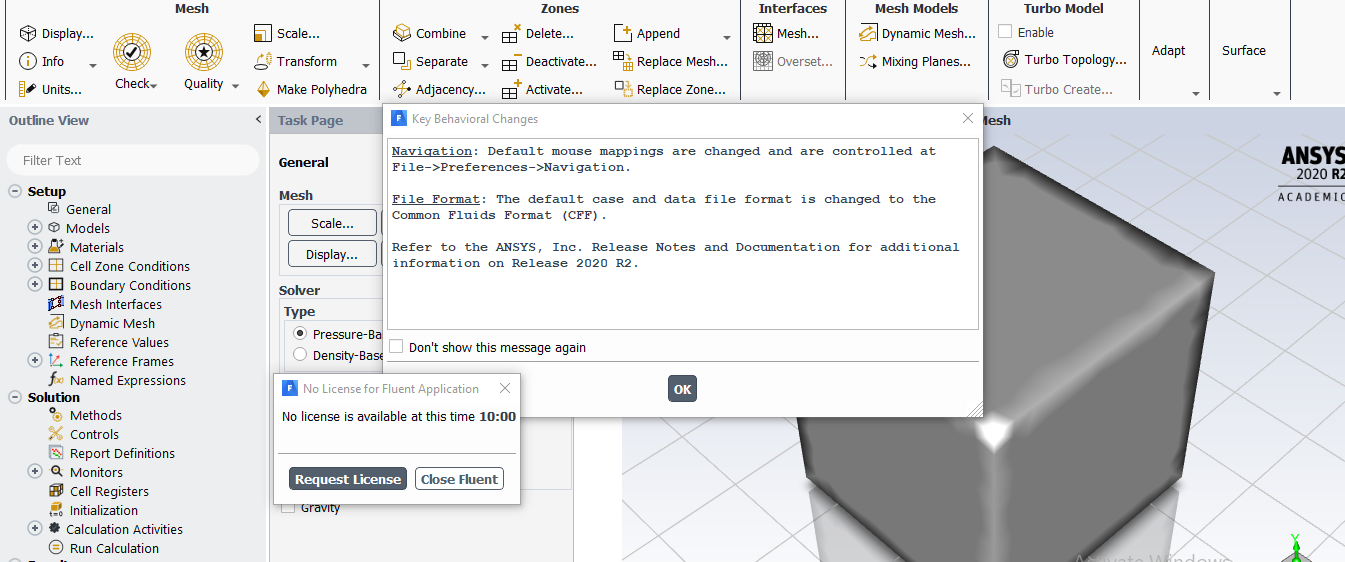

I have a problem with a fluid license when I do FSI coupling between fluid and structural analysis. I used academic peak age software 2020. the error attached below.
thanks in advance.
October 20, 2020 at 12:26 pmANSYS_MMadore
Forum ModeratorYou need to have 2 licenses available to run FSI and would need to set your license preferences in the Client ANSLIC_ADMIN Utility to 'Use a separate license for each application.'nnThanks,nMattnOctober 22, 2020 at 1:40 pmShaimaa
SubscriberThanks a lot ,nAfter I used a separate license it worked.nRegards.nViewing 2 reply threads- The topic ‘License Error’ is closed to new replies.
