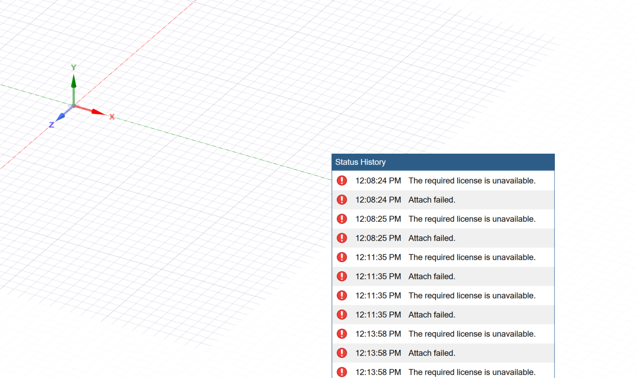

Does that happen with any file or with this specific file? Did you get the same error after importing other format files?
Will it be possible for you to share these file, so that I can try them on my end.Â

Hi Devendra,
I tried several different .prt files created in NX, I have attached a couple of random part files here

Devendra Badgujar
Forum ModeratorHello David Rendall
You are getting those messages due to the input NX file version not supported in SpaceClaim 2021 R2 version.
Currently, SpaceClaim 2021 R2 supports NX1 through NX12 and UG v11 through 18, 1872, 1899, 1926.
The next release of SpaceClaim (2022 R1) will support NX 1953. This version comes out in early 2022.
(Note, I was able to open the .prt files created in NX you sent me in a SpaceClaim 2022 R1 build)Regards.
