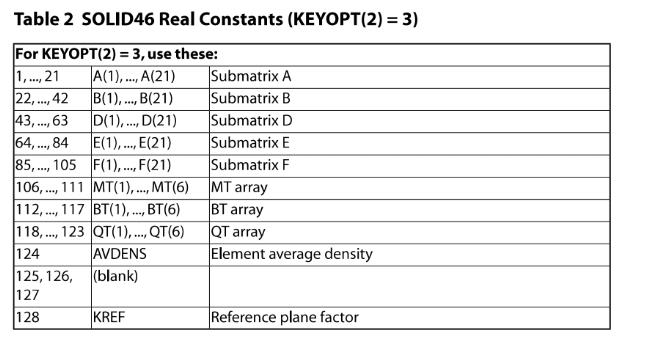

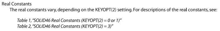

SubscriberCan anybody help me with the real constants needed for Solid 46? I have an old code which is using Solid 46 element definition. What are the new elements which can be used in place of Solid 46?

It would be a great help if you could post the link for SOLID46 real constants. I have tried searching a lot but couldn't find any source. -
