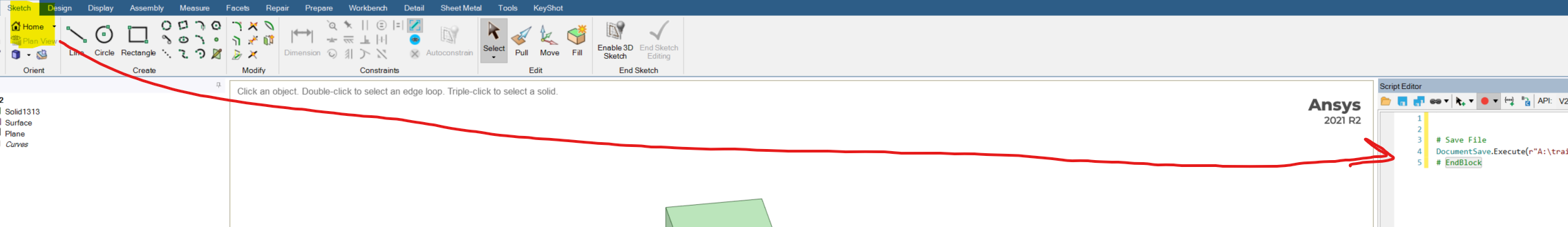

I want to use a python script to execute the "Home" button in order to have the best view before I save as a png file.
However, when I record, no history py appears?
Can I do that?
May 19, 2022 at 11:59 amAniket Chavan
Forum ModeratorViewHelper.ActivateNamedView("Isometric",1,0)
This should work.
-Aniket
