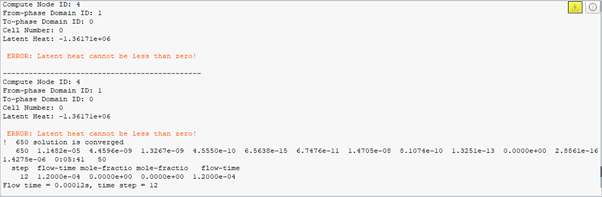

Ashi_Chauhan
SubscriberI have a question about the evaporation-condensation, Lee model. It is a release of liquid hydrogen (LH2) in the air medium where the temp. is 283.56K, LH2 release temp is 20and saturated temperature is 20.324K. I am using the Multiphase mixture model with energy and K-E model and mass species transfer from hydrogen-air (hydrogen, nitrogen & oxygen). I am having an error of negative latent heat transfer and simulations couldn't continue. Could you please tell me where I am wrong and how to correct this error?                                                                                                                                                                                                                                                                                                                                                                                                  Â
March 15, 2021 at 3:40 pmRob
Forum ModeratorIf you check the material properties are the reference enthaplpy temperatures the same, and if so what is the latent heat? nMarch 15, 2021 at 10:17 pmMarch 16, 2021 at 12:50 pmRob
Forum ModeratorIt means we didn't have the data when the materials were defined; the Fluent database can have missing entries and all values should be checked before running the model. If you find the latent heat and add it to one or other material (use + or - to suit) that should solve the problem. nDecember 12, 2022 at 8:21 amSree Kumaran
