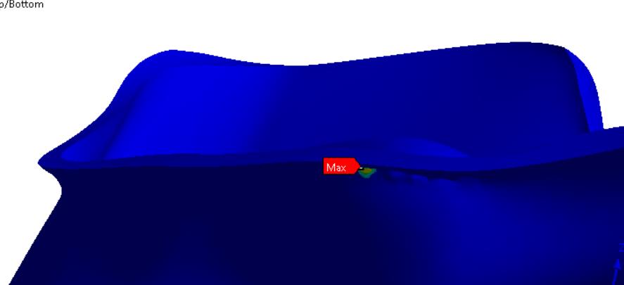

Could you please give me your point of view about the following problem when running my simulation?
Basically there are two bodies (A and
one (A) surrounds the upper part of another (
and is bonded to this latter. In fact, I have assigned a frictionless contact between the anterior surface of body B and the inners surface of body A. A displacement is applied to body B in order to move anteriorly until touching the inner surface of body A and unfold it to allow the stretching due to the displacement. the top surface of body A is constrained in the space in the three degrees of freedom.
During the solution, the body B moves correctly against body A (picture 1), but then high distortion occurs at the border that if fixed and divergence occur (picture 2).
Do you have an idea on how to solve the problem?
The material of body A is hyperelastic, Mooney Rivlin to allow a great deformation.

SubscriberIf you have SOLID187 quadratic tet elements, use Keyop(6)=1 for mixed u-P formulation and use many substeps.

SubscriberYes, there is solid element 187 10-nodes and I have already written the command keyopt (6)=1. My substeps are 10, 10, 100 since at the beginning no bisection occurs and simulation runs well. The first bisection occurs around iteration 50 that is about 50% os simulation. So do you think I should increase both the minimum and maximum number of substeps? I have also used the snippet command nequit, 100 since it happened days ago that simulation stopped to converge without errors, probably due to the standard number of iterations exceeded.

SubscriberIf your simulation runs well for a while at substeps 10/10/100, then gets into trouble at about 50% of the applied load, it is a good idea to break the simulation into two load steps. The first load step is half of the total and can complete at 10/10/100 then the second load step to get to the full load can begin at 100/100/1000 substeps. That way, you don't slow down the first half of the application of load.

thanks for the tips. I have run the two steps simulation by increasing the number of substeps in the second half, but it has just diverged without errors except "The solver engine was unable to converge on a solution for the nonlinear problem as constrained. Please see the Troubleshooting section of the Help System for more information". I've got also this info "The time for solution exceeded 1 hour. A High Performance Computing (HPC) license will reduce your solution time. Consider using an HPC license or purchasing an HPC license from your ANSYS Representative".
The Newton-Raphson residual plot is the followingÂ
elements violations are associated with the area represented in the plot.
However, It seems that the problem is the hardware configuration probably. I'm trying to run with two additional cores, but I don't think that it solves.

I can definitely say that the problem is not the PC, I have tried to increase the number of substeps as you suggested and to refine the mesh by creating a body sizing in body A and a face sizing in B, but the error is related to highly distortion of elements in the region of the previous image. I'm thinking the problem is due to the fold of body A since the top surface slightly folds inwards and then stretches out.
The material is a Mooney Rivlin hyperelastic, thus it is quite deformable.
