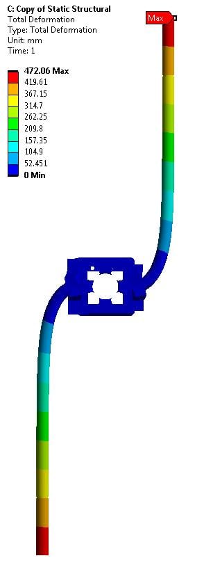

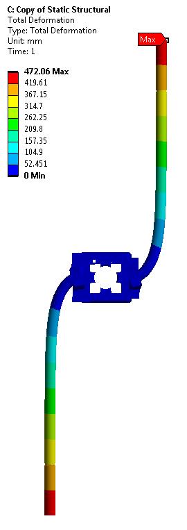

Facing problem regarding Large deflection results in the model, figure pdf file attached in this message. Also when trying to check results using ''true scale'', unrealistic results of deformation are been observed. Please can anyone let me know what's wrong with the results? what could be the reason of such results and how can it be corrected ?

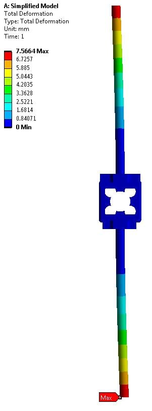

SubscriberI made a simplified version of your model and it gave the correct handle deformation as shown on the left.
I need to review your model some more to determine what went wrong with it as shown on the right.
The model has 349 N.m of Torque applied by 500 N at the end of 349 mm long handles.
Attached is the 2019 R2 archive.

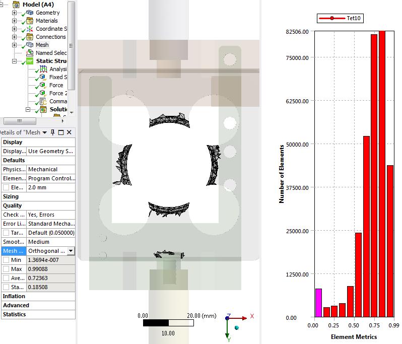

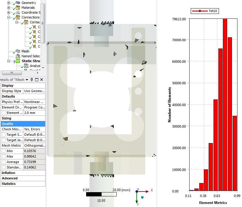

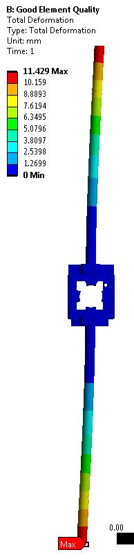

SubscriberOkay, here it is! Element Quality. Here is the Orthogonal Quality of the mesh with the incorrect deformation.
If I go into SpaceClaim, and cut away the geometry that has these bad quality elements, I can get this mesh:
Results
An element with an orthogonal quality of 1E-7 destroys the entire solution.
ANSYS 2019 R2 archive attached.

August 29, 2019 at 8:48 pm
peteroznewman
SubscriberDear Nadeem,
The elements are not broken, they just have a very, very, poor shape. It is possible to get good element shapes on the threads, it would just take a lot of elements and you wouldn't be able to solve it on the Student license. The workaround is to remove the threads so that you can get good element shapes without using a lot of elements.
Poor element quality destroyed the numerical precision in the solution process. This is a known fact about FEA (and CFD) and is why there is a mesh quality section in the Mesh details so you can evaluate the element quality before you solve. I should have checked this earlier, but I finally remembered to check it.
