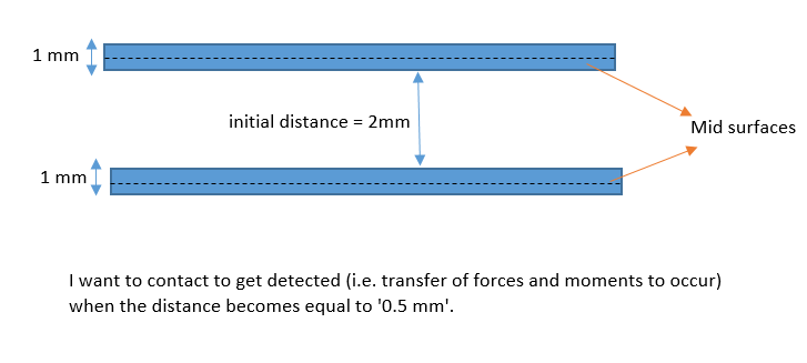

 Assume I have two parallel surfaces of thickness 1 mm (and having a 2 mm of initial gap between the extended faces of the mid surfaces) where I want to apply a frictionless/frictional contact as soon as the gap between the extended faces of the mid surfaces becomes 0.5 mm [esentially meaning that the contact should become closed between these faces when the gap between them is equal to or less than 0.5 mm]. If I want to turn on the 'Surface effect', how can I model this contact? What pinball radius should be chosen? Will chosing a very high pinball radius like 10 mm, create a problem in correctly detecting the contact (closed and open) during the solution, instead of choosing a low but sufficient pinball radius like 0.75mm?
 I think that if I choose 10 mm, then the initial contact status will be closed but it will remain closed even if the distance between the extended faces becomes greater than 0.5 mm, which I don't want to happen. I think that 0.75 mm makes sense because even if the initial contact status shows open, but when they come closer than 0.75 mm, the contact becomes closed. Does an initial contact status shown as 'open' for frictionless contact cause a problem during the solution?

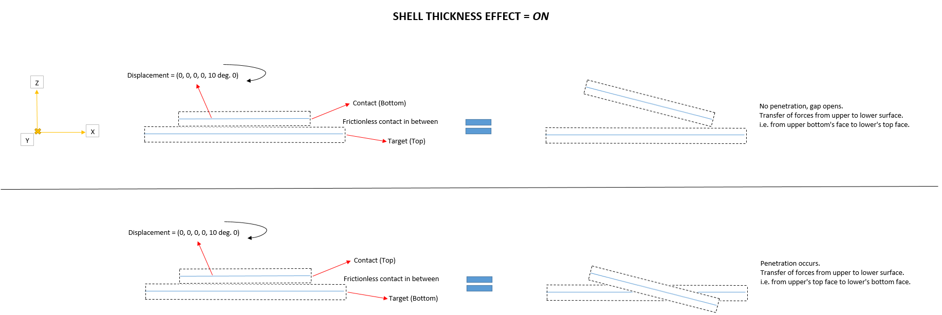

January 18, 2021 at 5:08 amRameez_ul_Haq Subscriber.peteroznewman, sure sir. Beneath you can see an illustration.  Now I hope you would be able to understand my previous question clearly :) Now I hope you would be able to understand my previous question clearly :)And I dont know sir why you said that it becomes more confusing by talking about shell thickness effect because if I turn it OFF, and if I input a pinball radius of for instance 0.75 mm, then the contact would only get detected when both the mid surfaces comes equal to or closer than 0.75 mm (but I want the contact to get detected when the extended faces of the mid surfaces becomes equal to or closer than 0.75 mm), am I not correct sir? I think this is a huge difference between shell thickness effect ON and OFF, which should always be considered.
January 18, 2021 at 5:46 ampeteroznewman SubscriberArray
 In the example you show, with the shell thickness effect turned on, contact will transfer forces when the distance between between the midsurfaces is less than 1.0 mm since there is 0.5 mm of shell thickness effect on each body. Yet you say you want the transfer of forces to occur when the distance becomes equal to 0.5 mm. That is what I find confusing.
 Now the initial distance you show is 2.0 mm, but that is to the contact and target surfaces, not the midsurface. In that example, the transfer of forces will occur when that measurement becomes equal to 0.0 mm.
 I think you are confusing pinball radius with contact offset. Contact offset is the distance from the nodes to the contact surface. With shell thickness effect turned on, the contact offset is automatically set to half the shell thickness. If the shell thickness changes, the contact offset automatically updates to half the new thickness.
 There are times when a surface is meshed with shell elements and Shell Thickness Effect is Off. In your illustration, imagine those blue solids had the faces of the solids that are closest to each other copied and pasted as surfaces. Now you would want the shell thickness effect turned off since the nodes are on the "outside face" of the solid. When this is done, it is possible to put the shell thickness on the correct side of the nodes. This is done by using a Section Offset. That means the center of the cross-section of the shell is offset from being on the nodes. In the example where the nodes are on the outside of the solid, the offset to the center of the cross-section is half the thickness.
 As long as you use a large pinball radius, the contact offset will exactly determine when contact forces begin to be transferred.

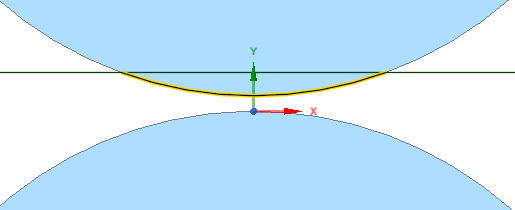

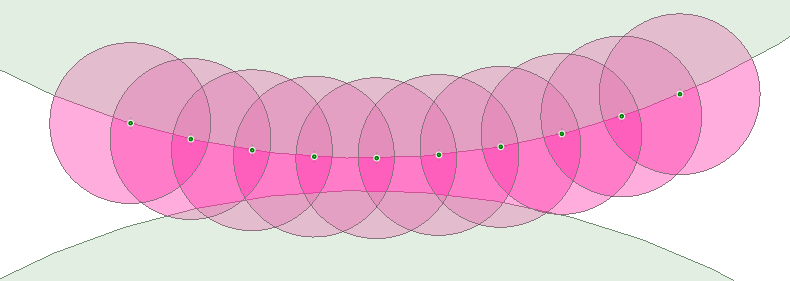

 "The pinball radius controls how far up the cylinder the new elements are created.", which cylinder? Both cylinders? Or only the one with contact face? Or only the one with target face?
 "In the illustration below, the line is 5 mm above the origin. If a pinball of 5 mm was used, there will only be contact elements on the yellow part of the cylinder, even though the entire cylindrical surface is scoped to be in the contact definition.", You used origin to address the center of sphere of pinball, but where actually is the pinball radius measured from though? Because whenever we use the pinball radius option in any type of contact, it just randomly pops up on a point on the contact face. This is an important question I think because it will determine the total number of CONTA or TARGE elements to be created.

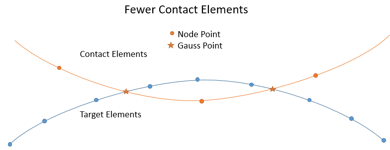

February 22, 2021 at 4:17 ampeteroznewman Subscriber.Rameez_ul_Haq By default, contact is detected at Gauss Points. The illustration below shows contact elements half the size of target elements. This shows zero penetration.  The illustration below shows target elements half the size of contact elements. This shows zero penetration. Note that the real penetration is larger than the reverse element size shown above. The illustration below shows target elements half the size of contact elements. This shows zero penetration. Note that the real penetration is larger than the reverse element size shown above.
 . The extra elements on the target side don't really do anything to better define the shape of the target surface. I hope this explains why it's better to have contact elements to be smaller than target elements. The extra elements on the target side don't really do anything to better define the shape of the target surface. I hope this explains why it's better to have contact elements to be smaller than target elements.

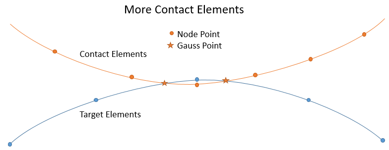

February 22, 2021 at 6:45 pmpeteroznewman SubscriberArray
 Physical penetration increases when the contact elements get larger. The reason is the Gauss Points get further apart. The curvature in the Target surface then poke further into the other body in physical terms, even though the mathematical evaluation of contact penetration is zero.
 Shell thickness effect is independent of what I am showing. I am showing the contact elements. I don't care if those contacts elements are sitting on top of the shell elements (shell thickness OFF) or if the contact elements have been offset from the shell elements (shell thickness ON).

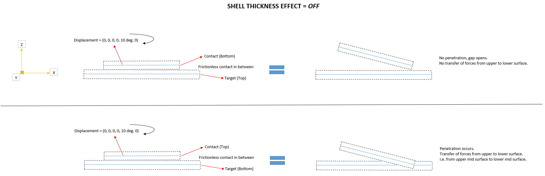

February 23, 2021 at 5:16 amRameez_ul_Haq SubscriberArray, when I try to use a contact between two surface bodies, I get an option to choose Top or Bottom for each, i.e. Contact shell face and target shell face, right? I am simply asking if I turn OFF the shell thickness effect, then choosing the Top or Bottom for the contact shell face and target shell face will become completely irrelevant right? Since the force transfer would be occurring on the mid surfaces only.
 If I have the shell thickness effect turned ON, then only choosing the correct Top or Bottom face for contact shell face and target shell face will be meaningful, right?
February 23, 2021 at 1:26 pmpeteroznewman SubscriberArray
 Imagine you have two horizontal shell bodies that are touching with frictional contact with shell thickness turned OFF. One body moves upward. Does that create a gap or penetration? It depends on how you set the Top and Bottom entries on the contact definition. Only you know if you intend that movement to be a gap or penetration.

February 25, 2021 at 12:06 ampeteroznewman SubscriberArray
 You describe the same scenario I gave you to imagine. For Frictional contact between shell faces, correctly choosing Top and Bottom matters. It is the difference between a normal movement of one surface relative to the other creating a gap or a penetration. You are wrong if you think it doesn't matter. For Bonded Contact, Top and Bottom doesn't matter because the two surfaces have no relative motion. We are only talking about Nonlinear Contact.

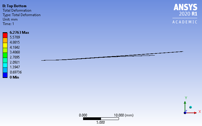

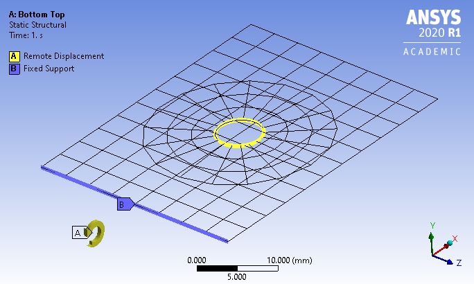

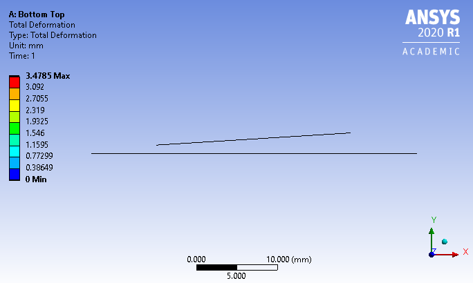

February 25, 2021 at 12:55 pmpeteroznewman Subscriber.Rameez_ul_Haq Below is the example I have been describing. Two shell meshes are in the same plane. The long part is fixed on the left edge. The short circular part has a remote displacement that applies a 5 degree rotation about Z. Frictional contact is defined between the two surfaces. The Target side is the long rectangle. The Contact side is the short circle. Below is the result when the Contact on the short part is set to Bottom and the Target on the long part is set to Top. A gap opens up. Below is the result when the Contact on the short part is set to Top and the Target on the long part is set to Bottom. Penetration causes deformation of the long part. .
February 25, 2021 at 5:21 pmRameez_ul_Haq SubscriberArray, was the shell thickness effect turned OFF or ON in this example?
February 26, 2021 at 2:33 ampeteroznewman SubscriberArray
 Shell thickness effect was turned OFF.
